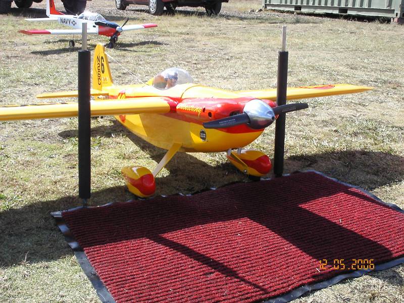

G'day Mate,
Have a look at these restraints, that we use in our club, here they are manditory, take note of all the above posts, they are correct, & these restraints will stop the plane moving, as you run up your motor & do preflight checks.
They also alow you to tune your motor, & be sure it aint going anywhere.

PS Alan is right, the tail trap is the best thing you can do, our club requires them.

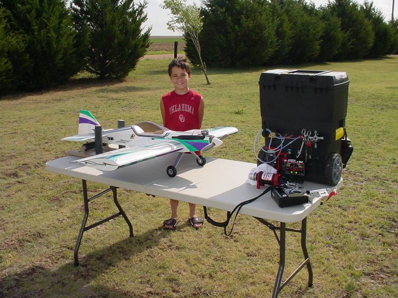

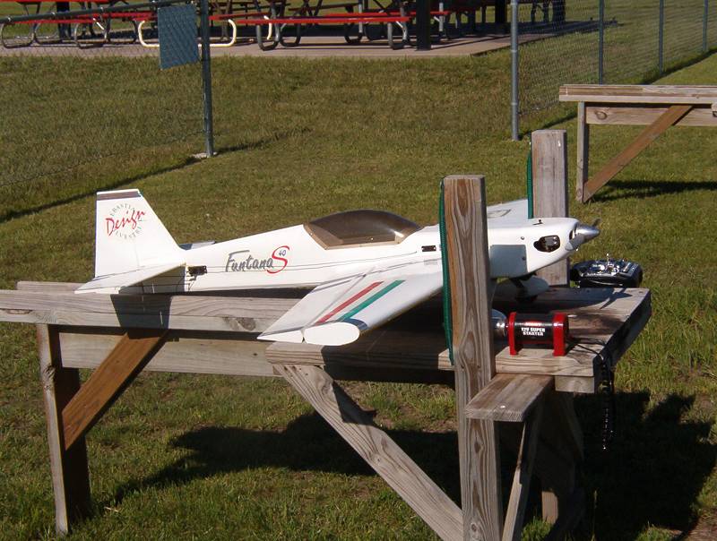

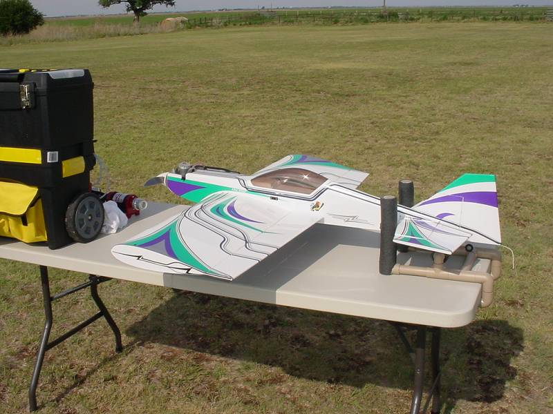

Our club built 6 of the Meroke tables (seen in Huskerboys picture) and we love them. They restrain the plane during starting, and make it easy to walk around behind the plane to make tuning adjustments. They're also at a perfect height so you're not bending over near a spinning prop. With the side wings, there really isn't an easy place to stand beside the engine that puts you in the prop arc.
