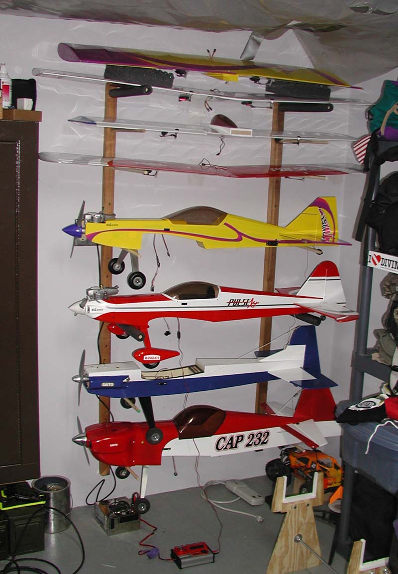

Will hanging my planes after use this way damage them? Thanks

it may not hurt them, but i would consider some way of storing them nose up hanging by the landing gear. remember the horizontal stab isn't designed to carry the weight of a plane.

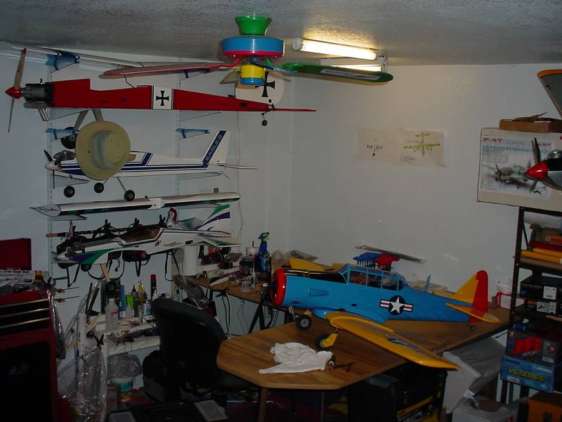

It is not the best way to store them but it won't hurt it just make sure there is good padding at the tail.
A better solution would be to lay them flat on shelf racks. Go to Home Depot or Wal-Mart and get 2 adjustable shelf tracks and 8 10in arms along with some insulation for plumbing pipes. It is very inexpensive and a better use of the space. Look in the background of this picture and you can see what I am talking about.
Have fun.

thats the way I store my planes also, it works well and you can adjust for wings and fuselage as needed, different planes come and go they are versatile.

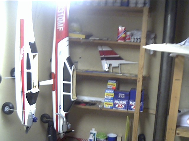

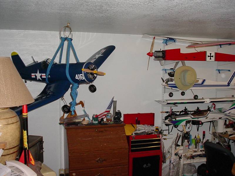

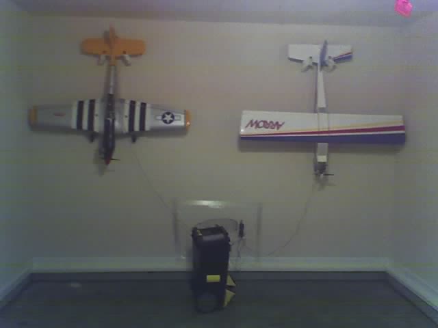

I hang mine by their tail and they do just fine. I have never had a problem with the clunk. It also keeps the front bearing oily that way. Almost everyone I know does this to save space. I inculded one for the wings in case you hadn't thought of it.
