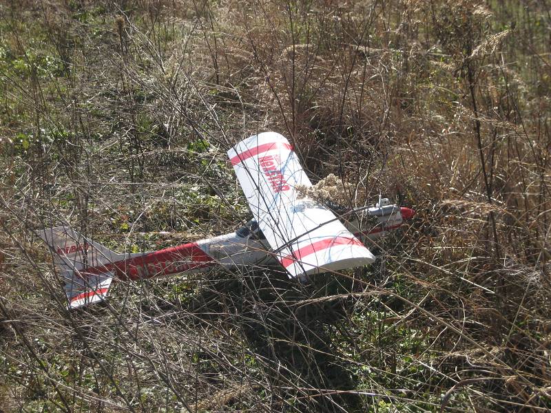

No harm done but 2 weed landings and one landing that nearly hit the weeds today

Make sure you check the tail properly. I had several weed landings during my learning and it almost always loosened the tail section.

I was high over the field but not high enough for an approach so we had it 7/8 down the runway when we were at like 15 feet so we banked it into the weeds but it was smooth
so no chance of us landing on grass or runway so .

a landing where you can fly your trainer again is a good landing, getting it on the ground in one piece works at first. as for the tail just check the nylon screws no big deal as long as they are snug there fine don't over tighten you will just be digging into the fuse the bolts are stronger than wood for sure.
the NEXTAR is a tough plane and will take a modest amount of abuse at least mine did .

if it cuts at full throttle its lean, right? if it bogs down its rich.
turn the Highspeed needlevalve... anti-clockwise when your standing behind the engine with the backplate facing you, turn it 1/8th of a full turn and see if it still deads, then turn another 1/8 e.t.c

If you have the OS .46 FXi, I have the same engine from my old nexstar and it is very reliable. Do you have a different engine? Are you at a high altitude with low nitro % fuel. I run the 15% synthetic blend with a kiss of castor added for good measure and fly at about 4-500 ft above sea level.

That engine should be VERY reliable.
Maybe it's TOO rich on the low end?

Okay, the Nexstar's white monocoat can be very helpfull. After you run the engine at full throttle and get a good stream of goo running under the wing and/or under the fuse; What color is is the goo? If it's still just as green as it was when it left the bottle you are to rich. When mine is running it's best the "goo" is barely green and has noticable carbon in it (black stuff). If your instructor is trying to tune for smoke trail he may have gotten so rich that the engine is not getting hot enough to produce smoke. The other posibility here is your glow plug may not be staying hot enough. Go to you LHS and step up the heat... good idea now with winter comming fast anyway.

Its black brownish I remember from last time.

Change your glow plug.
