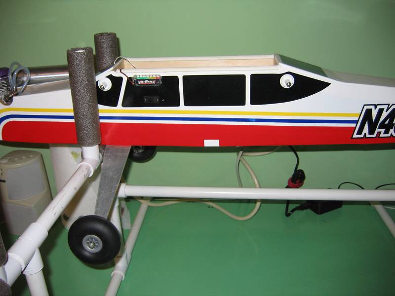

Essentially what we (notice not just I - my instructor gets all the credit here) was the following:
1. Seal up the nose wheel mounting and pushrod ports.
2. Mount some Four Star 40-ish looking landing gear ahead of the CG. Approximately in-line with the leading edge of the wing. Added copious amounts of ply here inside the fuse to reinforce the landing gear. This ended up being 2 blind nuts just ahead and 2 just behind the front former underneath the front of the wing.
3. Cut out a small amount of the leading edge of the elevator directly underneather the rudder.
4. Attach a tailwheel with a arm that leads up and follows the contour of the underside of the rudder. Sheathed this in fuel tubing and T-pinned the tubing to the bottom of the rudder. So the the tailwheel and rudder both are positioned by the existing rudder control / servo without adding additional control rods. Yes - that is lead weight.
I don't want to wander too far into "thread hijack land". Feel free to PM me with additional questions.
