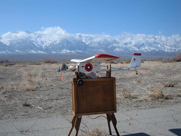

TimC's Avatar
Posts: 2,281
From: Lone Pine, CA
Default RE: hard to fly trainer
I own the stick 40 plus (with ailerons) and have flown the stick 40 without ailerons. I didn't like the way the latter one flew at all. I added a servo powered tail wheel to improve ground handling. The engine is a Saito .56 which moves it right along. The 40 plus flies as well as any other trainer I've flown with the exception of outside loops. It just won't do them. I'm using quite a bit more throw on all control surfaces that what is recommended in the instructions.

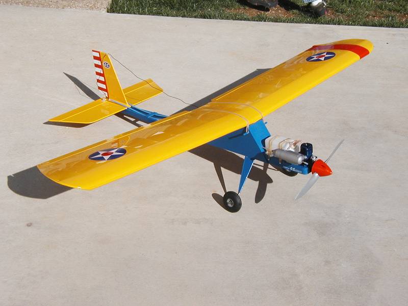

Posts: 722
From: Wingina, VA
I just checked my drawing and it shows the balance a 2 3/4 inch from the leading edge. I sold the Stick to a coworker and he has the assembly manual. I don't remember the recomended control throws. Mine was a Stick 40 with a wing I built with strip ailerons and a center servo similar to a Sig LT 40 wing. mine had a 46 LA on it and was a taildragger. It tought me how to fly and was a nice plane.
