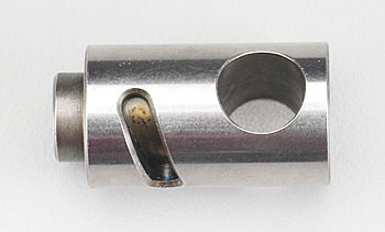

FastSky,
Please post some photos of these stuck Super Tigres if you would. I have many Super Tigres and they are great. The engine out, dead stick issue in Super Tigres is usually due to the low end out of position, too much nitro in the fuel, too lean, or wrong glow plug. I usually put an OS #8 plug in, run Wildcat 10% Notro with 16% Castor, and run the engine just a tad on the rich side. As far as the barrel sticking, this may be from Gumming Up of the carb barrel from whatever fuel you are using, or there may be a burr or nick in the barrel slot. A little pollishing may resolve this issue. I have a Super Tiger 90 2 stroke in my 1/6th scale Pica Waco YMF5 that weighs 11 pounds. That engine can pull that gal through any maneuver I put her through with power to spare. Good luck to you.

The "or there may be a burr or nick in the barrel slot" < this is the problem! Some that I have seen haven't looked that bad but still caused the barrel to jam. Others that I have seen are so bad it looks like the slot was ploughed out making a high ridge along both outside edges the length of the slot. I am not sure how these barrels worked at all without jamming immediatly! As I stated before I can't get any pics right now because I don't own any of these engines myself and never will. I only brought the issue up to point out that to me, there are more user friendly motors available in the same price range. [8D]

I had the same problem Fastsky describes right from the beginning with a ST G-45. I tried honing the barrel with emery cloth with only limited success. I think if I had a solid throttle pushrod or a nyrod instead of a cable, it would have been OK. Otherwise, I liked the engine. It was just starting to get nicely broken in when I pulled back rather than forward in a low level inverted pass. The carb's in a few pieces now.

Hi jagnweiner, the carb barrel is a very small part of the problem. The bigger problem is in the round part that turns in the barrel and opens or closes the air gap at the top of the carb barrel. Its called a carb rotor and the problem is where the angled groove is made in the rotor. It has to be smooth on both sides and getting it smooth has alsways required a fine tooth file. The metel is tough and emery cloth won't do much of anything. I finally found a pic of it you can see what I am talking about. [8D]

When I said "barrel", that's the part I was referring to. Like I sad, the point is moot after the crash. The crankcase is broken beyond repair. I will say the ST was running well enough to reach impact at a high rate of speed. I had to dig it about 6" out of the ground.

Throttle barrel jammed in flight(!) due to a rough surface of the throttle barrel. Run the engine at full throttle until end of tank and glided the plane in. What a surprise to discover the reason after deinstalling the carb.

Yeah, that's exactly what happened to my ST 45. Right there on the slot in the barrel. Jammed during flight, no kiddin'!
