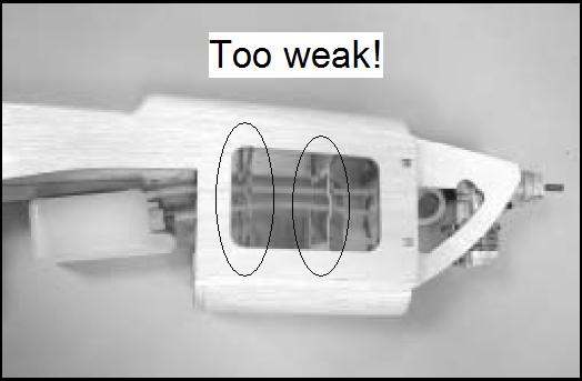

Couple of things you may want to do before you do its' maiden.
Re-enforce the inside of the fuselage where the leading edge of the wing is. It is a weak spot and the fuselage may crack there on anything but a perfect landing. (Dont ask how I know about that
Check the firewall. MANY of the ARFS are coming through with firewall just butt glued to the fuselage sides AND with hot glue. If you don't see any re-enforcement on the rear of the firewall, I would epoxy in some basswood tri stock (the U-CAN-DO is VERY well known for this firewall problem. A friend had the firewall on his U-Can-Do pop out the first time he started the engine )
)Check the firewall. MANY of the ARFS are coming through with firewall just butt glued to the fuselage sides AND with hot glue. If you don't see any re-enforcement on the rear of the firewall, I would epoxy in some basswood tri stock (the U-CAN-DO is VERY well known for this firewall problem. A friend had the firewall on his U-Can-Do pop out the first time he started the engine )

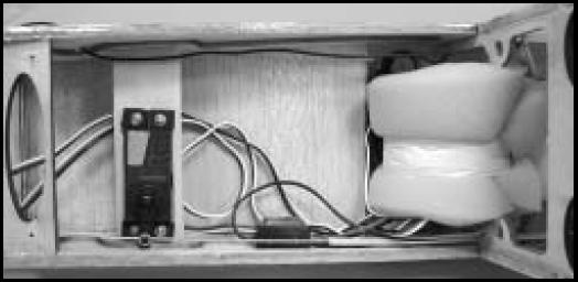

Mounting the receiver/battery is very very tough. The instructions show them being tied to the fuel tank mount, but like I said, that wood is VERY thin and weak. It's like you could blow on it and it would snap. I might end up cutting up some spare balsa and building a kind of mounting bracket for them and epoxying it in. They just kind of flop around right now.
I guess I would have to say that I'm not feeling very comfortable with the plane. It seems like there are so many things on it that are weak, too thin, not laid out very well (battery/receiver mount) etc. It feels like on the very first flight it'll just fall apart. I have to spend some time this week going over the entire plane and finding the parts I'm not happy with and fixing them. I have some 1/16 and 1/8 5-ply that I can use, and I can pick up some triangle stock when I go to the LHS.

Measured out a piece of 5 ply to cut and install into the fuse to hold battery and receiver. I might cut out a flat piece and cut holes in it like my Avistar, or I might just epoxy in two pieces of small dowel and use Velcro strips. Still trying to decide. I also don’t want to screw up the CG, since if I epoxy something in, the choices of battery placement are severely limited. Thoughts? I probably should have taken pics to show the space I have to work with. The attached screenshot from the manual will have to do.

Yeah I know! Just the slightest pressure and I heard little tiny cracks. I ended up sanding them down a tiny bit.
Problem is, the instructions tell you to mount he rx/batt to the first former. That's the part I don't like. With it set up that way, the rx/batt kind of float around. Lots of movement.
1. Don't breathe ANY fumes or dust that can be avoided.
2. Often weight can be saved in plywood by using lightening holes. Pay attention to strength though.
3. Flimsy balsa can sometimes be strengthened by soaking with thin CA - watch out for fumes. Do all trimming prior to CA due to hard to sand after.
