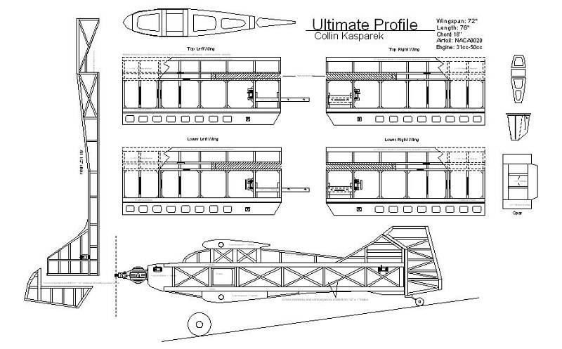

For a few years now, I've had the urge to get into giant scale. I've also loved the way biplanes look, but I've never owned one. I also like 3D, but I've never owned a 3D plane... It seemed only logical that I should build something to cure this problem
I wanted something unique, so I decided to design my own. Now, I'm very new to CAD, in fact, this is the first set of plans I've ever drawn on it, so any tips or suggestions would be great. Since I'm new to it it’s hard to put my ideas onto CAD with any degree of accuracy, so use you're imagination to fill in the gaps
The engine I'll be using is a 52cc [link=http://video.google.com/videoplay?docid=7063498753981003477]Chainsaw[/link] [link=http://video.google.com/videoplay?docid=1899399485091143431]Conversion[/link]. It was tached at 9000rpm+ with an old 20x10 Dynathrust prop. For servos I'll be using "Tower Pro MG995" (Ya, I had never heard of them either). They're digital and @ 6v they produce 208oz/in of torque and a speed of .13sec/60degrees. Not bad for a $15 servo. I'll be using 9 of them. 2 on the elevators, 2 on the rudder, 1 for the throttle, and one on each aileron (total of 4).
There’s a number of things on the plane that will be different than what you see on the plans. For instance, the sides of the fuselage will be covered with carbon tape from the TE of the wings to the nose. The thickness and number of ribs has also been changed since I drew the plans and I don’t really feel like taking the time to change them.

Looks interesting to me. I would like to see some pics as you frame it up. A couple of questions/thoughts. Why are the AILE servos so far inboard? I would build up the AILE out of square stock and move the servos out to the center. Or better yet build the AILE as a part of the wing and then cut them out. Are you going to gang the rudder servos and use a pull/pull? I don't see the stab on your plans.
