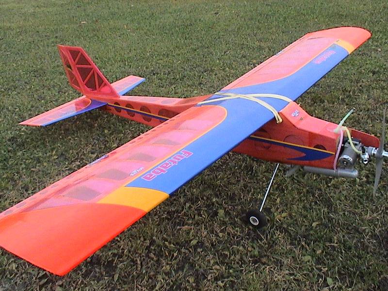

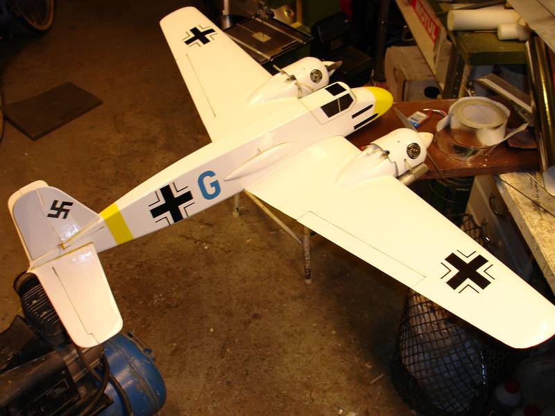

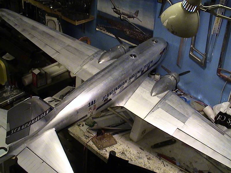

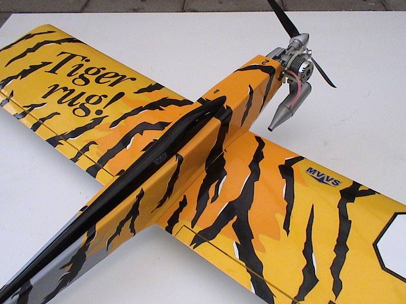

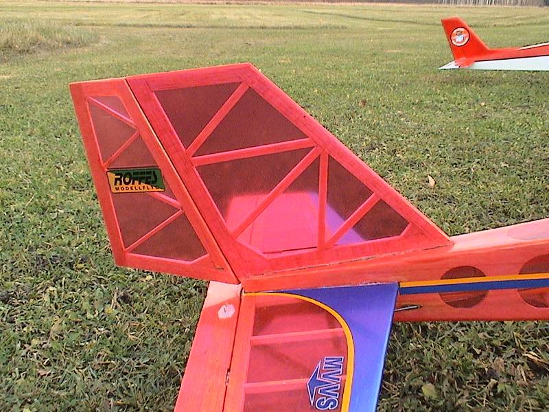

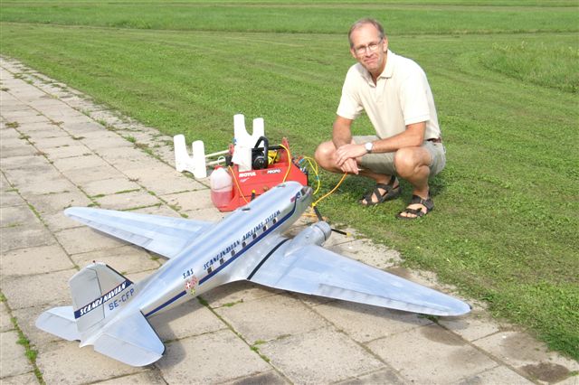

Hi!
Oracover (Ultracote to you Americans) is much easier to use and much stronger than Monokote.
I have used both since I started flying R/C 31 years ago but prefer Oracover, and recommend it to all newbies starting out in R/C.
