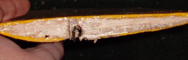

I flew my hobbieco supperstar 40 today for the second time in as many days. A club traner via buddie box was helping me learn to fly. I took over at an altitued of about 125' at half throttle,I flew it about 100 yards and the wings folded.The traner took over cut throttle and tryed to fly it down,to no avial.Ofcourse its totaled.The wing comes as a two piece to be epoxed together by the builder.Upon examination of the joint my epoxy work held,but it is very evident that the wing was not glued corectly at the factory.The sandwich of the adjacent rib had little glue applied,and this is where the wing seperated.Has anyone had any experiance with Hobbieco on something of this nature.If so what do you think? Will Hobbieco replace the plane,or am I screwed.Any info will be appreciated.Thanks

Did you use a wing joiner? I tried to re-epoxy a together that had broken in half and it failed on the first flight because I didn't think the wing joiner would be that big of a deal and I didn't cut it out ot replace it or use another. Lesson learned on my part.
Here is a pic of my wing after the second failure. I Have cut the wing joiner out now as I intend to fix it again. On mine the epoxy joint held firm it just ripped the wing rib out of the wing.

try fiberglassing the wing joint. it makes lot of diff.

I have a superstar. Did you insert the steel bar into the wing halves during assembly? If you didn't use the bar, you're probably not gonna get your money back as hobbico would judge that to be failure to follow the directions. Best of luck

There is no metal to be installed.In my prints or in the box,it calls for a wood joiner,which I installed.Yes Im sure if I glassed the wing together It would of held,but why spend all that time and money buying mat,white covering,then red.yellow and blue trim tape.This was supposed to be an ARF not a kit.There are at lest 6 other super stars in my club none have had to glass theirs.The plane was built exactly to instructions,but thanks for the input.I took it back to the place of purchase and they agreed it was falty workmanship at the factory.They also said that Hobbieco was good to work with .I see monday.

The ARF version comes with a wood joiner and The RTF version had a steel rod for a wing joiner. I just learned of this myself so I thought I would pass it on
