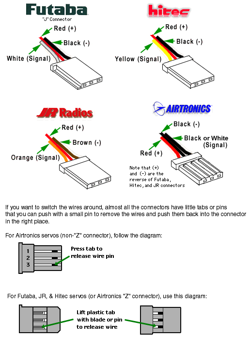

1. The JR Quatro is a FM transmitter so you need a RX that is compatible with their "positive shift" modulation system. These days virtually ANY servo will work with ANY RX. You MAY need to trim off a polarity key on the outside of the plug like on Futaba servos or you may need to change the wiring in the plug very slightly, easy to do. RCKen has a nice diagram of this I'm betting he will kick in here with soon.

4. The servos don't care what they are plugged into as long as the wiring code matches. They work fine with AM, FM, PCM and Ouija boards
. Well, OK maybe not the last. Digital or analog, all work fine. Digital usually use more power depending on torque available.Edited to correct shift types. oops.
