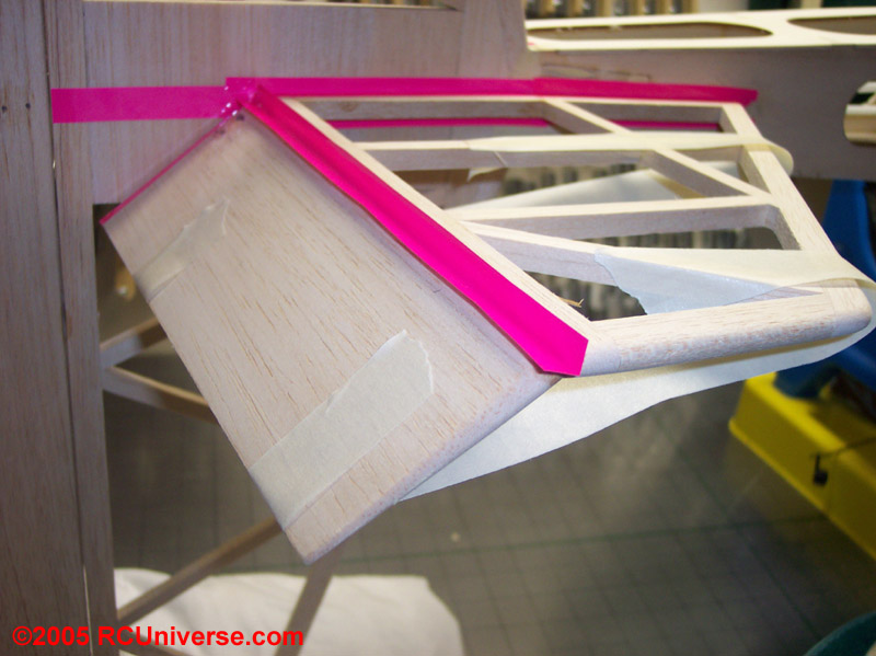

overbored77,
It's not really too hard to do with covering.
1. Use tape to fully deflect the surface you want to seal the gap for.
2. Cut a strip of covering long enough to cover the entire hinge line (if possible). Fold the strip in half and set in the gap.
3. Use a trim iron (or the tip of a covering iron) to iron down one side of the strip against the "V" of the gap. Make sure the fold of the strip sits all the way down in the gap
4. Now do the other side of the gap with the trim iron.
5. Now use the covering iron to seal down the rest of the strip onto the control surfaces.
6. Trim the ends of the strip.
7. Now flex the surface and then inspect the gap. If there are any parts of the strip that came up use your trim iron to seal it back down.
Do both sides of the gap this way. Doing this will reinforce the CA hinges to help prevent failure.
Hope this helps
Ken

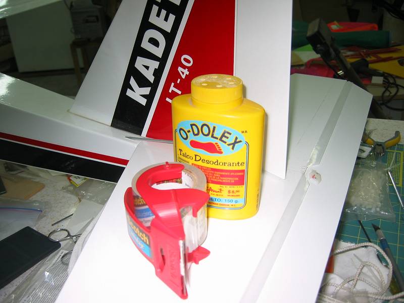

If you do not have the monocote and the covering iron; I have neither so
1) I took a measured length of HD 3M packing tape, and put it onto a section on non-stick paper like what the decals come on;
2) figured I wanted 1/2" inch adhesivese sticking to the forward top side of of hinges; measured the width of the hinge depression (45 degree slopes) and added an additional 1/8";
3) cut tape to width;
4) expose the portion you want to make non-sticky. Sprinkle with talc, rub in, shake off excess;
5) carefully align and apply;
6) press down gently and work any air bubbles to sides.
Unconventional maybe, but it may be a long time before I would have access to the tools and monocote so.......... it should work to stop any flutter.
