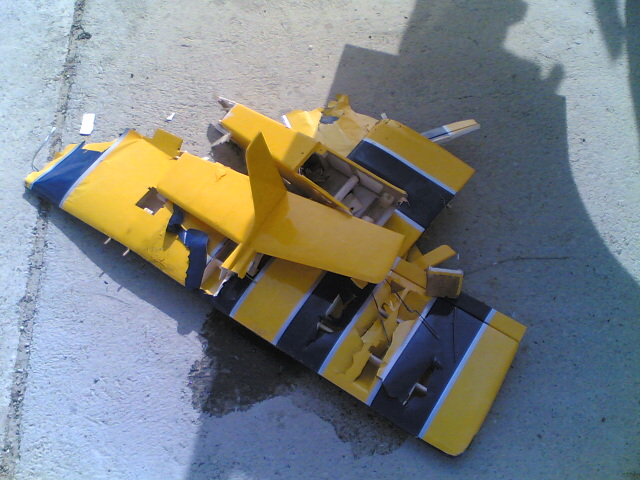

Joined: May 2006
Posts: 20
From: Tehran, IRAN
Default RE: Sr-falcon
thnaks every body.
yes i will fly it whith a OS .61 FX i think it is good enaugh !!
about the dehidral , i've decided to ake its wing in two parts, and madular. because it W.S will be 76"
so I should make it whith 0 degree in dehidral !!
I built a 69" wing span one which crashed while inverting!! here is its picture
appreciate any suggestion !!
[img][/img]

Old 01-31-2007 | 08:19 AM
Joined: Nov 2004
Posts: 11,701
From: Memphis, TN
ORIGINAL: hamed-khorrami
thnaks every body.
[img][/img]
A little CA and epoxy, good as new. Suggestions? Fly higher until you get the inverted thing learned. Leave room for mistakes and recovery.
