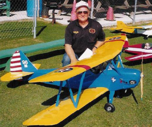

This model, 101" w/span, 28#, machine Zenoah G-62 electronic ignition has served its purpose for some 10 years with two Hitec 425 equivalent servos on the ailerons, and one 605 (now 635) on the elevators, with standard servos on rudder and throttle. Definitely good enough for me.

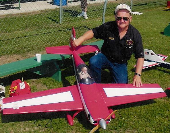

The red machine flew well also with about the same line-up except 2 605s on the elevators. It got sold after serving me for about 3 years. 1.20 2 stroker. 72' w/s.
