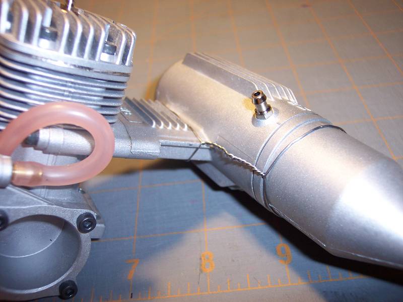

when you get it replaced use either 60 thousands wire or a nylon strap fastened to the mounting area by the engine and wrapped around the second half of the muffler where the exhaust is. the reason they come apart is the center bolt comes loose and vibrates off. with safety wire or a nylon strap all you will lose is the center bolt and that is easier to find than the back half of a muffler. I had the same thing happen to me and started safety wiring the sections together.

Here's what I do to my mufflers so I don't lose the back half.
Ken

Another problem the OS mufflers have experienced is the muffler loosening up from the engine. When you safety wire the back half of the muffler to the front, it doesn't hurt to wire the front half to the cylinder at the same time. I've seen more than one OS muffler retained this way.

I've never had a problem with the actual muffler coming loose. I use locktite on the muffler bolts so they stay in place. The problem with the back half of the muffler coming loose is because the bolt breaks. Once it's broken I will drill out the holes and put all-thread through the muffler to hold it together.

Grab a length of 6-32 all thread from Home Depot or similar. Cut it to an appropriate length and put a nut on each end. (a second jam nut can be a good idea if you don't have a/c grade locking nuts). Leaks? We don't worry about no stinkin' leaks. Just drill each end of the muffler very slightly bigger so the all-thread just barely goes in. A #27 (0.144 in)drill is a good close fit.
