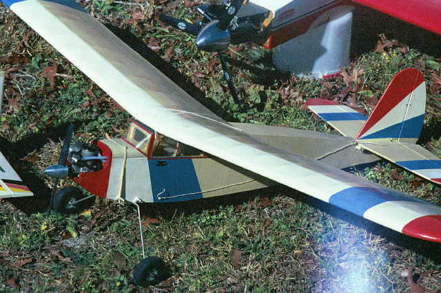

When your skill advances to the point that a crash is a truly rare event you'll want to do everything to maximize airframe life. I have several flying planes more than ten years old, and two that are more than 40 years old. Pictureattached is about 15 years old, worn out two engines, now has its third.
So don't be overly concerned about prop balancing right now, but do keep it in mind for later.
