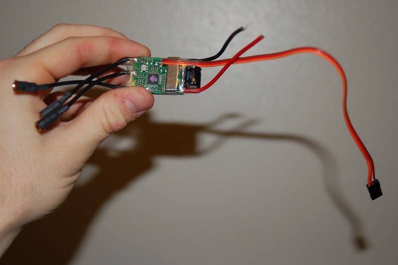

Ok, so now it's time for me to connect my battery, speed controller, receiver, and motor together. I have a Hacker Brushless A-20-20L motor, Hacker brushless X-20 speed controller, Thunder Power Li-Polymer 1320 mAh 3 cell, and a "Dean's Plug" (ultra plug). The way I see it is, plug the speed controller directly into the motor and into the receiver. Now, the part I don't understand is getting the battery to plug into the receiver. I was told that I needed this plug and to solder the battery to it. However, how do I connect the plug into the receiver? Do I need another cord that goes from this plug to the receiver to solder? And also, I have a friend who is able to take his battery off and recharge it while flying on another battery. How can you do this with everything soldered together? I can't easily get a hold of him right now, so I decided to post my questions on here.
Here's a couple pics.

What you do is this.
The Deans plus is intended to go between the battery and the ESC. The ESC should have something called BEC (Battery Elimination Circuity) which allows your flight battery to power your receiver through the ESC. If it has the BEC, then the ESC connects to the receiver and that is it. If the ESC doesn't have BEC, then you will need a separate receiver pack.
Your main flight battery (In 90% of cases) will not plug straight into your receiver.
When you have the Dean plug soldered to the battery, you can easily swap it out for another battery with a deans plug. Deans plugs are very popular because they can take a lot of current and are designed so you cannot plug the battery in backwards. Just make sure your ESC has the MALE end of a deans connector and your flight batteries have the FEMALE end.
In the end no part of your setup should be directly soldered to another. The motor should plug into the ESC, the ESC should plug into the battery, and the ESC should plug into the receiver. This makes it easy to change out parts if something fails.

I found that my speed controller does have the red and black wires to connect to the Dean's plug. So, if I understand you correctly... I just plug those in, while with the battery I solder? And where do I plug the ESC into the receiver, channel one or B/CH6?

The 2 or 3 THIN wire comming out of the ESC is for the throttle. It will have a connector on the end of it identical to a servo. If that wire has 3 wires going into the plug/connector, you have a BEC (Battery Elimination Circuit ). If it only has 2 wires going into the connector you do not have a BEC and will need a separate battery for the receiver.
The wire from the ESC gets plugged into the throttle channel on the receiver. For Futaba, HiTec and other negative shift receivers, this is USUALLY #3. If there is any doubt check the manual for your transmitter/receiver.
If your wire has 3 leads to the plug you are all set. If it only has 2 leads you will need to plug your separate receiver battery into an unused slot (or "Y" it if all the slots are filled)

Photo 1) The 3 plugs from the motor plug into the ESC.
Photo 2) The red and black wires from the ESC gets soldered onto the Male Ultra Deans plug.
Photo 3) The Female Ultra Deans plug gets soldered onto the red and black wires of the battery. This in turn plugs into the male plug of the ESC.
Photo 4) The thin single wire of the ESC gets plugged into the receiver.
Photo 5) The whole motor connected.
Thats all there is to it.

Unfortunately the only Deans plugs I know have to be soldered onto the wire. Which means the only way to charge a battery while using another is to have two separate batteries.
When I showed the pics of how to install it all I was assuming your equipment looks like mine. Is that true?
ESC has three banana jacks on one end to plug the motor plugs into.
ESC has one black and one red bare wire on the opposite end. Same end as bare wires has a thin wire for the receiver.
Battery pack has one black and one red bare wire.

I am not sure you are aware of this but the battery charger has to be changed to Male ultra plug as well so that it can plug into the female ultra plug of the battery. See pic.
And when you do the solder make sure the red wire (pos.) is soldered to the vertical plug of the Deans and the black wire (neg.) is soldered to the horizontal plug of the Deans.
Then before you solder the wires to the female Deans plug the female into the Deans male so you can match up the wires correctly. Then when you are sure where the wires go pull the two apart before doing the soldering on the female plug.
