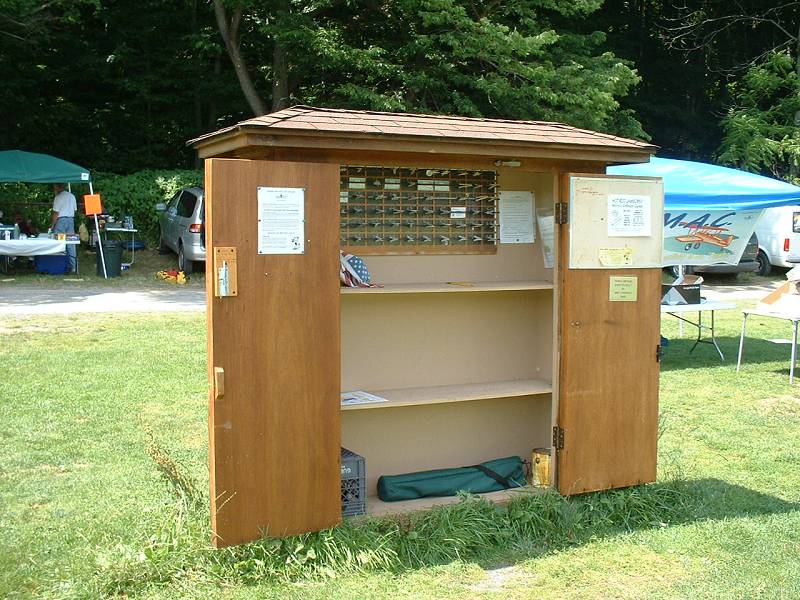

I used to have a channel 44 buddy, he always seemed to be at the field when I was or maybe I was always at the field when he was.
After a while we started greeting each other as "channel 44 buddy".
We shared the pin and there was never a problem and we both flew our planes alot.
I can see how it could be a problem if someone does not want to play nice, but fortunately in my case we were both very willing to share.

i never knew it was illegal. Does it also imply to 27mhz and 75mhz?[sm=confused.gif] I have changed my TX crystals before!.........now i know better.[sm=bananahead.gif]
My Feedback: (13)
when a service center changes freq. the transmitter is also electronicly verified to make sure the signal is correct and at the strength required for the unit to function properly, if its not, and the plane is out of range or poss. worse out of control thats where problems starts ie: crashing into the ground or worse into somone with the potental for a fatality.
when I purched my first ARF when the operator asked me( tower hobbies) what freq. did I want, my reply was whats the least popular freq.
so far at my club only one other member flys ch. 50 and he flys on sat.
usually sun is my day so there is no conflict but we also have a 15-20 min rule that says if your flying on a freq. and another club member shares that # then you have to surender the pin and place your transmitter in the impound until his/her time is up the rules are a guide and as long as the persons sharing the pin work out the time then the rule is very flexable until a pin hog trys to monopolize, then the rule book comes out and that ends any disagreement before it starts.
