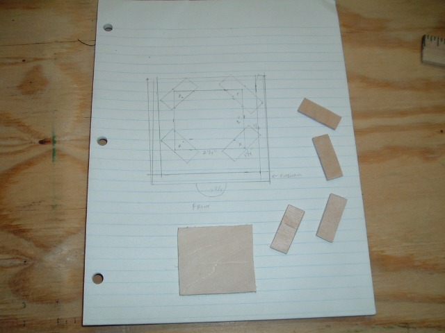

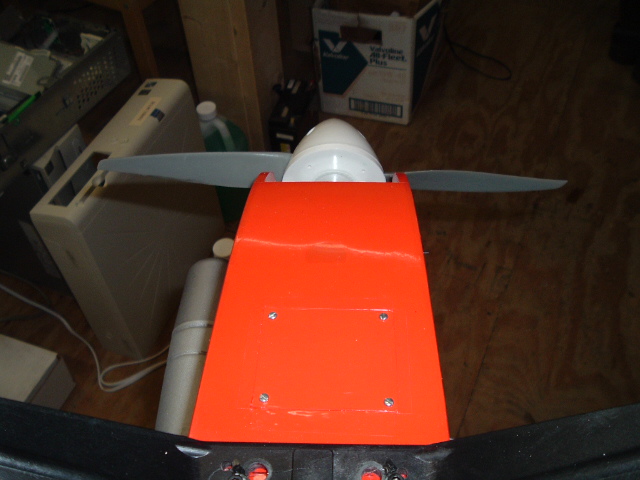

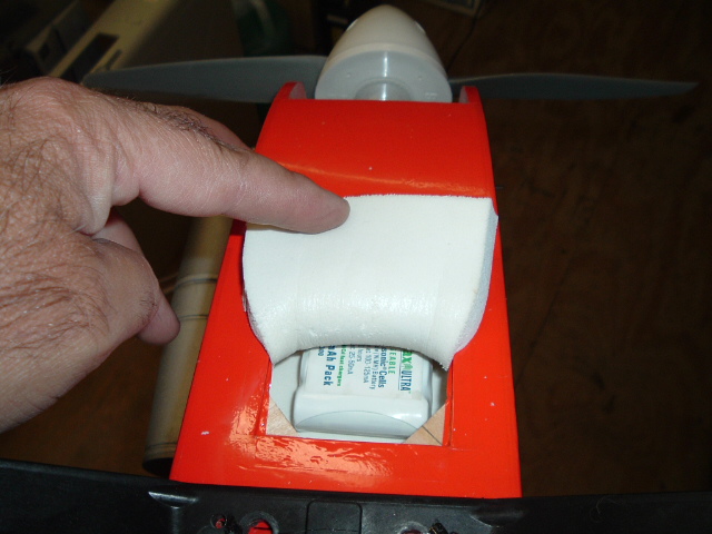

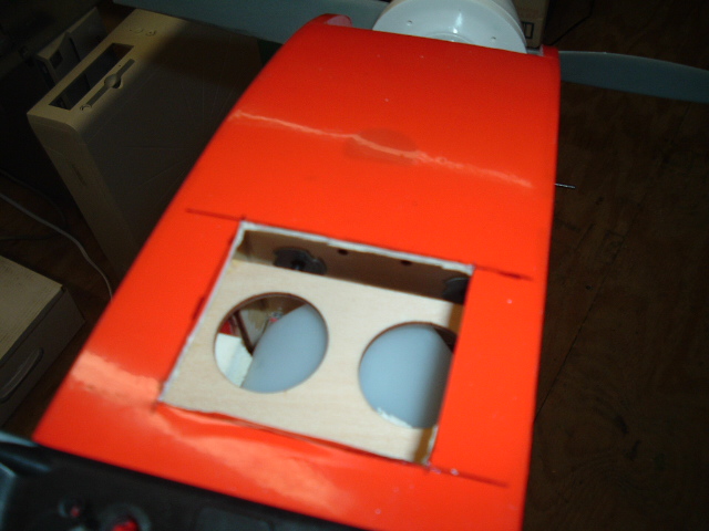

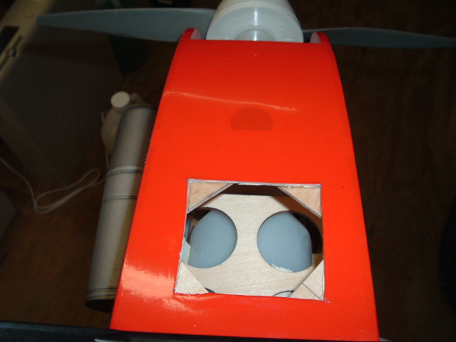

I used the void under the tank to put my battery right behind the firewall. Still room for more ballast up there if needed.
