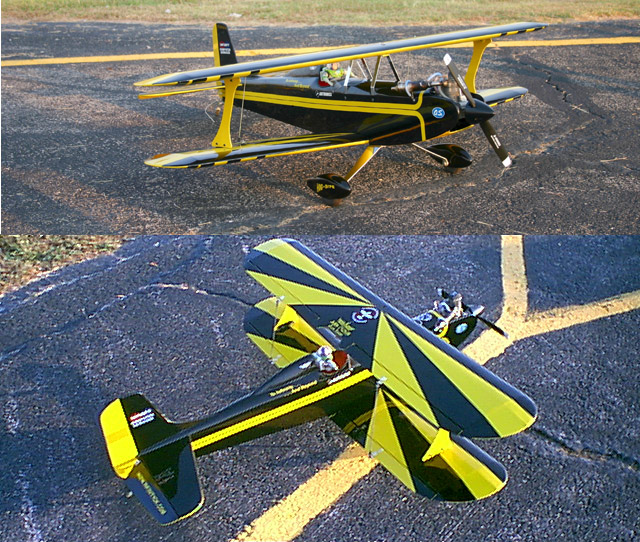

The picture that I use for my avatar is my current Hog Bipe. Here's a couple of pics of it.

Hey Ken,
I want one of those "if I wanted to Hover..." decals. Where'd you get it?

Nice Bipe. I especially like"If I wanted to hover, I'd buy a helicopter!

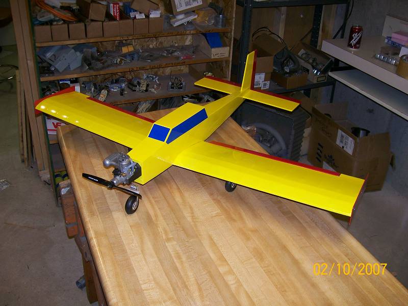

As far as covering goes, I was just as nervous. I didn't do anything fancy with mine but I wouldn't be afraid to try more on my next plane.
This was a scratch built from plans. I'm just learning to fly and not sure when I will maiden it.
Ken, that is a awsome looking bipe. I would love to build one but the trueness of the wings worries me enough not to attempt it yet. Maybe as a third build. Those decals are awsome, please let me know where you got them.

Ken, why is there fuel tube wrapped around the muffler on your Hog Bipe ?
Or is the picture just misleading ?

Nope, that picture isn't misleading. I was having a problem with this engine in this position, the muffler kept coming loose in flight. I tried evertyhing I could think of to get it tight enough, but it always came loose. So I came up with this. I use some steel wire rope to wrap around the muffler to hold it in place. The wire rope is inside of fuel tubing to prevent metal to metal contact. This has worked great. Tons of flights and it never comes loose any more.
