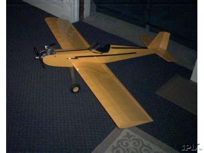

now how about some technical advice....... The plane is already built and has servos and a saito 50 on it. Can anyone give me some advice about setting the plane up...... throws,etc..... Please keep in mind that I am stepping up from a trainer and don't wan't it too wild!!! I am going to add a Jr r700 rx and use my XF421ex Tx with it. can someone give me their CG on this one?

The CG should be right on the center of the main spar. Ailerons shoud be 5/8" up and 1/2" down, elevator is 1/2" up and down, rudder is 1" left and right. If you go to RCU's search and type in four star 40, click on titles only you will find a wealth of information and pictures. Have fun !!!
Old 02-18-2003 | 08:50 PM
Joined: Feb 2003
Posts: 44
From: Lenoir NC
Default Advice:Sig 4*40
here she is.......

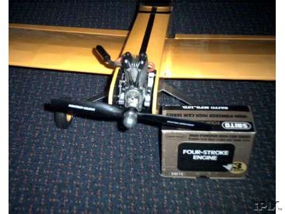

Old 02-18-2003 | 08:51 PM
Joined: Feb 2003
Posts: 44
From: Lenoir NC
saito 50
