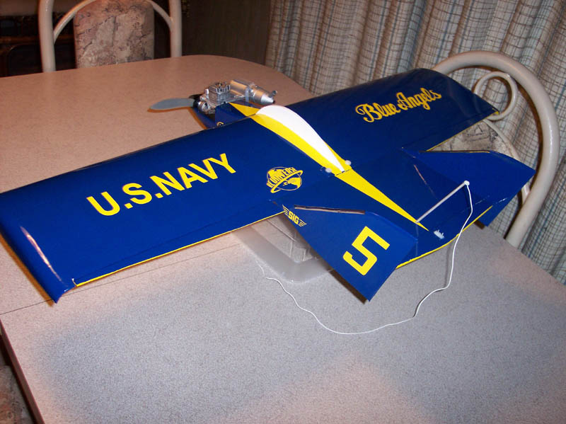

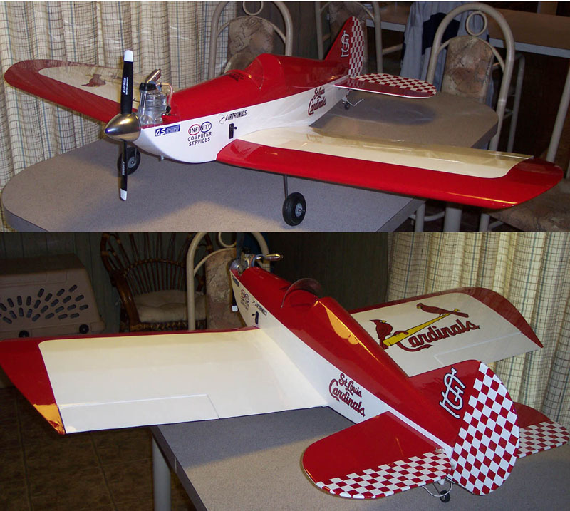

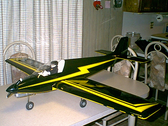

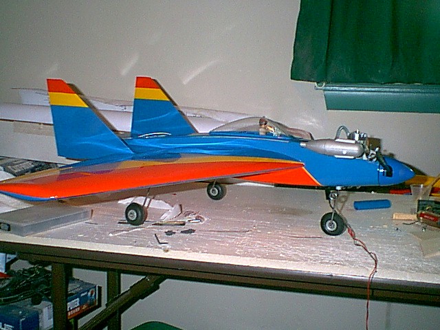

Here are some of the planes that I have built lately, all have been covered using only Monokote.
