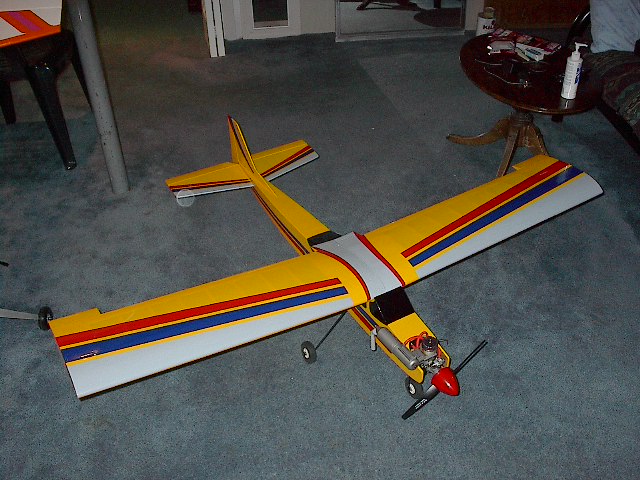

here's my next victim....lol. this is a 40 scale lanier explorer trainer that i won on ebay. i've got a new futaba flight pack w/battery on the way for it. a tower hobbies 46 will power it and i'll probably start with a 11/6 prop. it's got trike gear which i'm not thrilled about. i could probably fool around and convert it to a tail dragger but.....whatever...we'll try the trike and see what happens. so far the workmanship and parts are good quality and have been going together nicely. still in the early stages but it's coming together. it's always nice to start a new plane project.......and even better to fly it. "chow"
I started on that plane and am now flying an evolution of it.
The plane out of the box needs different landing gear, espically the nose gear. Get a dubro nose gear and put it on first thing or else you will be fighting steering issues. The stock gear bends like a paper clip and there isn't enough turns on the spring, so the front wheel is about 1/2" off center with every thing straight. It's install a new gear, or buy the props by the dozen.
Second bash I would do is to make new elevators, about 3/8" to 1/2" wider than the stock, scratch the 3/8", 1/2" minimum. At landing speed, there isn't enough athority with the stock elevators.
Wing incidence is off. Get some popcicle sticks and build a three high platform under the rear wing hold down screws.
Speaking of the hold down screws, deep six the blind nuts and the little screws. Drill and tap the block for 1/4-20 nylon bolts.
Other than the hardware that comes with the kit isn't so great, that's it.

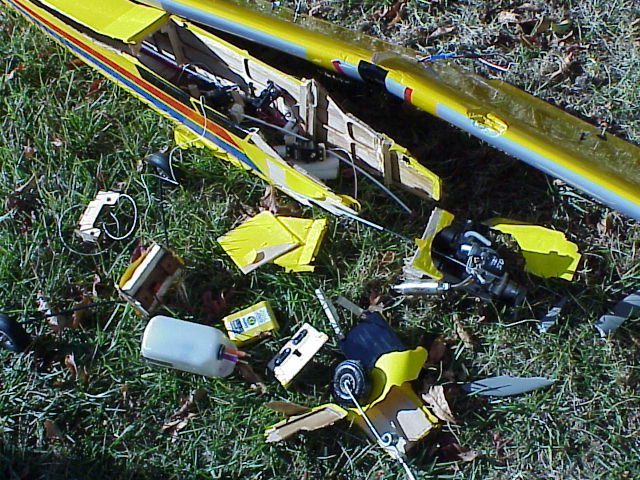

I totaled my fuselage on the top rail of a 2x6 board rail fence. From there, I built a new fuselage, on the stick design and lengthened the wing to rudder length by two inches and then added 1 1/2" between the wing and firewall. I also made the plane a tail dragger. I had fun flying that one, until I lost it to the creek monster. I had a spare wing, so I built a second and was trying to learn inverted flight and, well as they say, a picture is worth a 1000 words.
Now with a good fuselage and no wing, I scaled down the 4*60 wing and I am ready to test flight it Monday. I love the way the 4 * flys, so I'm hoping this latest evolution is as good.

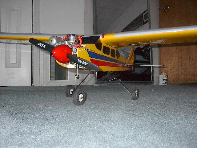

I bought this plane,and I'm still flying it.
The plane is real tail heavy, I had a 40la ,
moved the battery (nimh 1250) under the fuel tank.
Added ton of lead up front and a steel nose cone.
Still tail heavy...
Took off the 40la and added 46ax,took off some lead weight,
still using steel nose cone.battery still under tank.
now it is balance out and flys pretty good,FAST.
I have no problems with anything else.

Ditto on the tail heavy. I had an O.S. 52 four stroke on the dubro viberation mounts which really put it out front, and I still needed 6 oz of lead under the engine to balance it out.
It must be the wood. I have never seen balsa so hard. When I built the 4 * scaled down wings, copied the D tube construction of the Explorer. I used some Bass wood from an old set shutters I tore out of the house for spar and TE material. I was afraid it was going to be to heavy, but the new wing weighed in 8 oz less thant the Explorer wing. I would have bet it was going to be the other way around. One thing about the hard wood, it does take a beating. That fence, the first one, was just to much though. The wing only needed a small repair though.

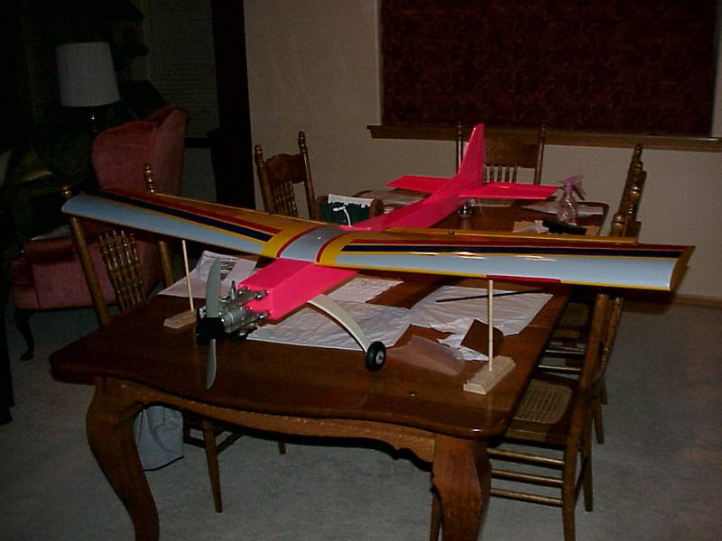

making progress on the girl...she's taking shape. need ca hinges to put the ailerons on. gotta make another order from the tower. throttle arm on the engine needs to be replaced too. $1.79 for that....woohooo! it's gonna break me...lol

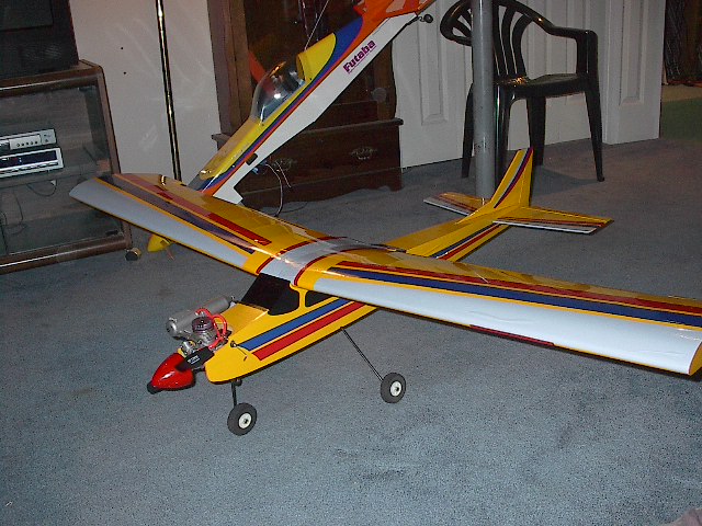

ok....i got my items from tower today for the explorer.....that ups guy....he's always right on time. i got a futaba flight pack w/nicd. i did up the wing first and ran some throw tests....she looks pretty good. i got the high and low rates set up and some expo dialed in. the throttle arm on the carb is junk so i had to order another one of those...should be here tomorrow. all the servos are in and the rudder/nose wheel are good to go and the elevator as well. i'll balance her up as soon as i get the throttle linkage hooked up and we'll see where the battery and receiver have to go. hopefully i wont need lead any where but, we'll see. then it's time to fire it up and see how it runs. i'll do that out in the garage....check for fuel leaks and anything else that might pop up....one never knows. so anyway, she's not a bad looking plane.....they always look good right out of the box. the covering job on this model isnt really the best that i've seen. hopefully, i can get the bubbles out of there and pretty her up for the big day...lol....probably be a while with this darn weather we've been having. it's supposed to snow again thursday 3-6 inches...what the heck? did anyone tell ma nature that it's spring????? she's a brat
Plan on adding some lead. I needed four oz under the OS52 four stroke. Don't be tempted to use one of the brass spinners, it add to much load on the crank.
I had to spend a couple hours with the heat gun getting the covering presentable. I found that if I used a strip of blue masking tape, I could lift the covering where it was stuck to a rib and that let things work out a lot better. Watch the covering, it doesn't change colors like Monokote so it is kind of hard to tell when you are about to blow a hole through it. I did manage to get it to look OK though.
I've had a marthon week, rebuilding crashes. I'm good now for two more before I get out the glue again. Speaking of balance, I forgot to check the balance on the 4* after splicing the fuselage back together. Got to do that before morning, just in case the weather is OK for flying.

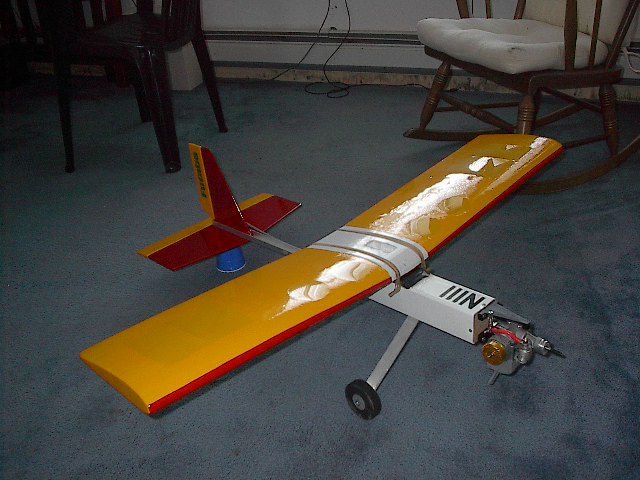

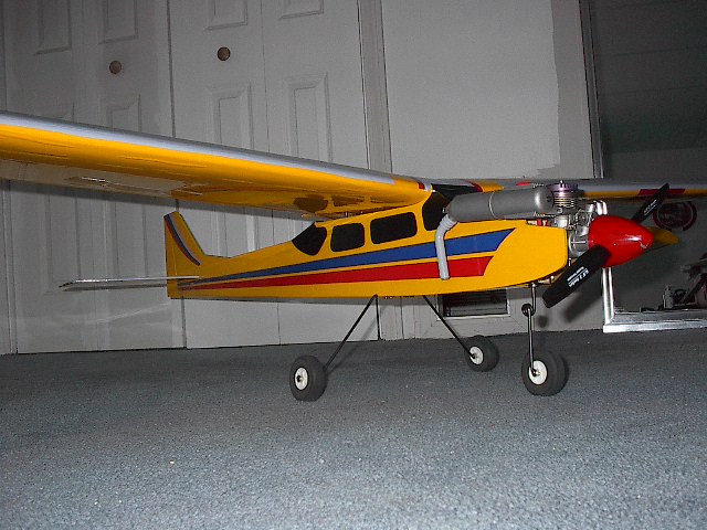

well don, be safe and happy flying. send some pics when you can. here's a pic of the warrior. this thing is fun to fly. and big...so it's easy to see for these old eyes..lol

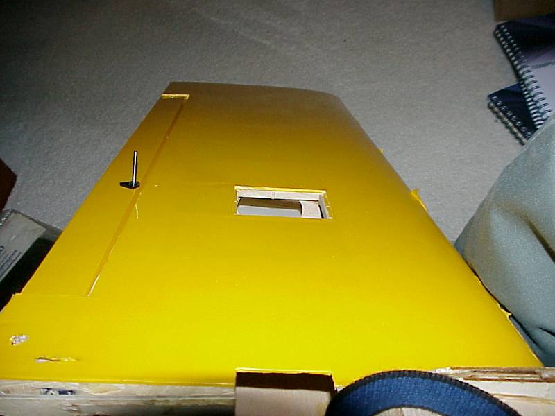

The aileron throws are another thing I worked on. I found that the torsion bar link was bottoming out way befor the aileron reached full travel. I used an xacto knife and lengthened the slot that the arms came through. That gave me another 1/4" throw in the down direction. A while later, I was having jerky response on the ailerons and discovered that the torsion links were slopping around in the wing and I would use up 15 degrees or so of servo movement before the aileron would start to respond. At this point, I changed over to two servos, one in each wing. I used a jewelers saw and with a fine hole next to the torsion rod bend where it left the wing, I cut the rod off. I was then able to pull the end out by removing the aileron and then pulling out the rod. I made a servo box in each wing.
I ran each wing off it's own channel to get a bit better tunning on the ailerons. I could have gone flaperons but there isn't really a need. This is the best mod I did. It smoothed out the ailerons and overall the flying of the plane. The first photos are of the mod on the half wing that I have left. The last is what the finished linkage looks like on the replacement wing I built.
I got to fly a bit this morning before the wind came up and blew us away. I about wiped out again. I was trying to do the left roll and the plane got a little out of sorts and when I pulled it out, it came over the pits, but high. I lost sight of it turnning and when I found it, I had made a U turn and lost almost all the elevation I had. I came back over the pits at about 10 ft elevation. I pulled it up and then went dead stick and managed to get it back on the runway with no problems. While I was refueling, and getting my nerves calmed down, the wind came up so I packed it in and called is a day. Lots to think about re-hashing today.

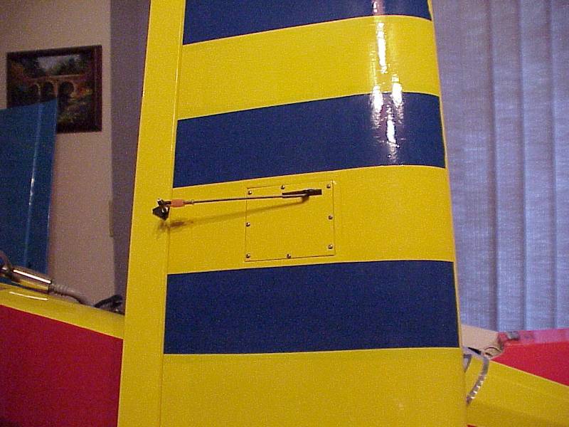

and thank you too campgems for those awesome pictures of your mods. very nice work on the servo box. i may try this same thing if i decide to keep this plane but probably not until next winter. i've got too many other planes to fool around with. i'll fly this thing the way it comes out of the box and we'll see what happens. right now, i've got it sitting on the C.G. machine and it's telling me it needs weight on the nose. about three ounces should do it. i'll mount some lead in such a way that i will be able to easily add or remove as the plane becomes more comfortable to me. after i've found the balance that suits my flying style, i'll burry it inside and out of sight. my aileron throws are a bit of a concern as well. they dont want to travel down as much as i'd like them to. as you said, the material needs to be trimmed back some but i'll try it like this first. i have a feeling i'm going to be asked if i would sell this plane anyhow as soon as the newbies at our field see it go. it would actually make a good plane for one of them if i can get it to fly decent.

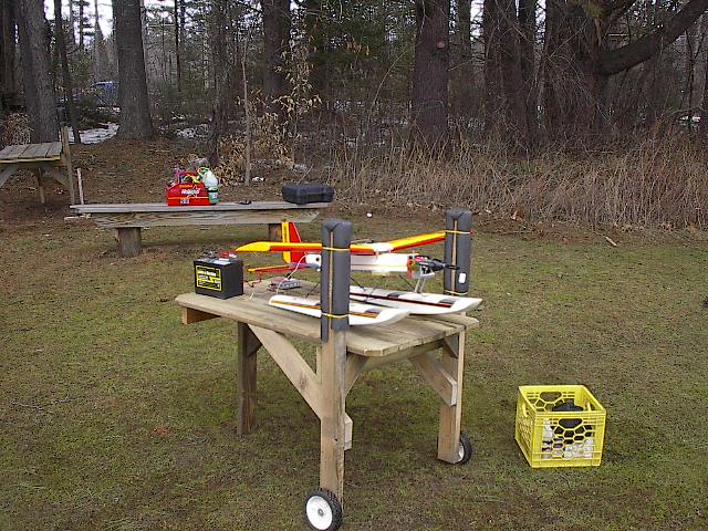

so anyway, we're going tomorrow and fly off the snow with the float planes. i put the floats back on the duraplane 20 today and balanced it up. the battery is cycling now and she'll be ready to go. i have a 40 engine on the thing..it's got plenty of zip with the 10/6 prop. i could probably put an 11/5 on there but i'm too lazy to change it. besides that, i've flown this thing already off the snow the way it is and it goes awesome. the best thing about the snow covered field is, your runway is "everywhere"...it's a riot...land way over there somewhere...taxi around a bit and take off again...land it over here..holy crap....it's endless fun. i cant wait.

well, we flew off the snow today. it was terrible for us guys with floats. the snow was very sticky and wouldnt let the plane get up to speed. for a smooth take off. our club pres. was there with his and he was smart enough to wax the bottoms of his....but mine went like crap. it dragged and dragged and finally when it cut loose, it shot almost straight up....what a handful. one of our female members had a kadet with skis. that was definately the way to go. i'm ordering a set of skis for my next adventure off snow. still fun to get out there and fly. here's some pics.
