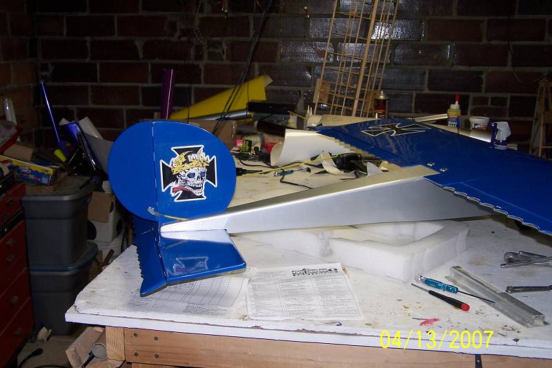

I built my prototype from the free DXF plans I offered on RCU a few months back. These plans show a new Compufoil fully symmetrical aerobatic wing without dihedral and medium/heavy thickness for mild speed. She built just fine for me and it looks great tell me what you think. A few other features are it’s a tail dragger, under wing servo hatch doors, and a forward fuel tank hatch that comes in very handy. Free plans link below.

I don't know if it's because of the plans or your building skills, but the plane looks great to me. I've nver been fond of the stik concept, but yours looks quite interesting. Thanks for sharing.

Thanks for the complement I enjoy scratch building very much I think it tends to make you focus more on the details so it looks and flies perfect. I also like the idea of changing things to make the plane fly the way you want it to. With some very basic airfoil knowledge and design concepts one can accomplish that goal.
Hey just got the tail fin art done how does it look? Real sick aint it!!!!!!!

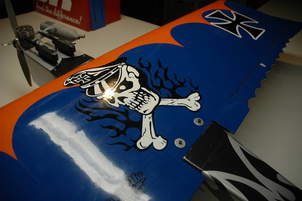

I have a nice printer plotter to print these stick plans, need a set give me a PM. Lots of winter building season left may just as well build one of these easy build Ugly Sticks way fun plane check out the videos.

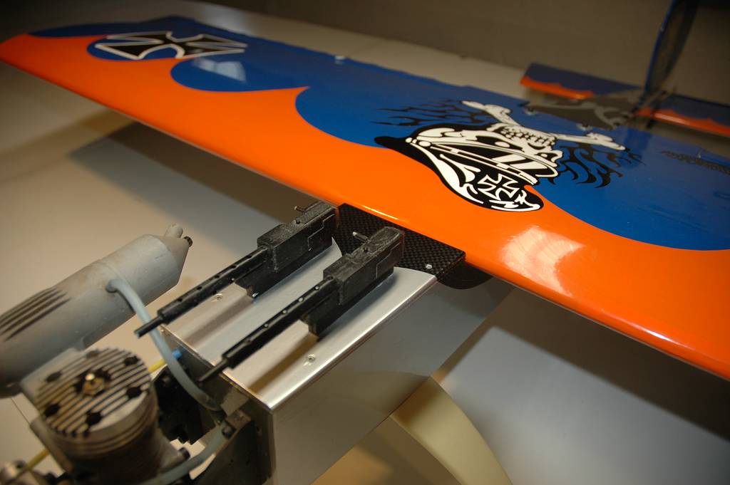

I scratched one out last summer from a similar plan. I plotted it out at about 75% size and flew it with a .25LA. It was a nice flying little plane until my structural flaws came to light and the wing came off on a somewhat hard landing.
It is now a piece of art hanging in my basement.
Yours looks awesome.

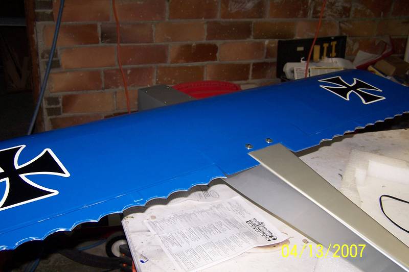

I love the way the sticks fly, but I have always disliked the scalloped trailing edge of the ailerons and the stupid looking round tail feathers. The versions with the more traditional ailerons and tail feathers seem to fly just as well and I like them. It's just a personal thing. Some guys may like the scalloped ailerons and round tail and it doesn't make them bad people. Does it?

Gene, I know what you look like, there is nothing stick about you!!! I will vouch for Genes printer, he does the best job I have seen printing plans!!
Max just doesn't like covering scallops is all!! They look cool and I put them on a lot of Bipes. It's also called an Ugly Stick for a reason!!

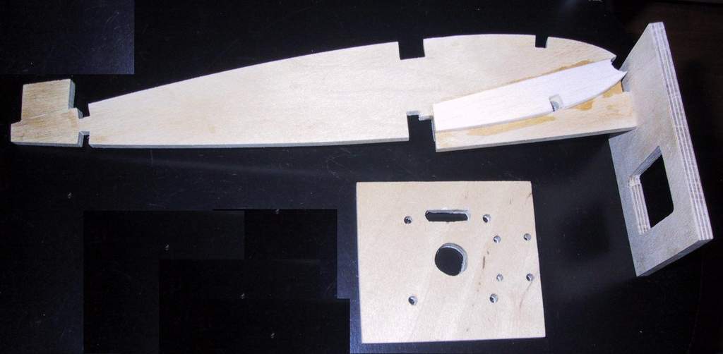

Anyone building this Ugly Stick feel free to post a build on this thread post any photos you have lets keep this going and going. What a great plane! I have some pics of the wing build the plastic ribs are templates for tracing the part for cutting and for repairs later if needed.
Notice photo below of wing hold down ply rib here you do not need the build tab on this rib because will be too hard to cut it off once it's in the wing being made of 1/4" plywood. Also notice the false rib for holding that spar end to the ply rib (Do not make the spar hole in the ply rib as shown this could weaken the wing hold down tab). This also provides some top sheeting glue surface on the hold down tab rib as well thus making this area even stronger, never a bad thing.
The tail plane and fuse pics shown below are an electric motor build it was made lighter with a built up vertical stabilizer and rudder (not as strong as sheet balsa for nose overs). The builder has omited the ply and 1/4" balsa sheet from the fuse by laminating two layers of 3mm balsa in key locations to save even more weight. That's the beauty of this model you can do just about anything you want to make it fit your flying needs.
If you have questions please ask me here so others can read them too and learn. I'm glad to help in any way I can. I also have some cool graphic kits for sale (seen above) skulls, knights and maltese crosses, flames and tribal designs among others for this model please PM me for details and price on that.
I'm also looking into getting some short kits made up as well you'll only need the spar sticks, wing LE dowels and sheeting. Let me know if there is any interest in the short kits (see first image below).
The last photo is another method of aligning all ribs for cutting on a scroll or band saw all at once this works very well.

Gene sees right through me!!! I haven't had the pleasure of trying to cover a scalloped edge, but I have looked at them and wondered how the hell to do it.

Simple cover the bottom first cut the covering 3/8" longer around the scallops. Iron it on the bottom and use the iron tip to curve the covering over the scallops edge just near the top. Now cover the top with a second piece making the overlap a bit less, this way you'll get all the wood covered. Keep the heat down which prevents the covering from curling onto itself as you work it over the edge, I have the best luck with Ultracoat it likes lower heat for curves. Not nearly as hard as it looks (see mine below) I have a two color scheme silver bottom and blue top and still kept the line separating the two colors dead center on the scallop's edge.
