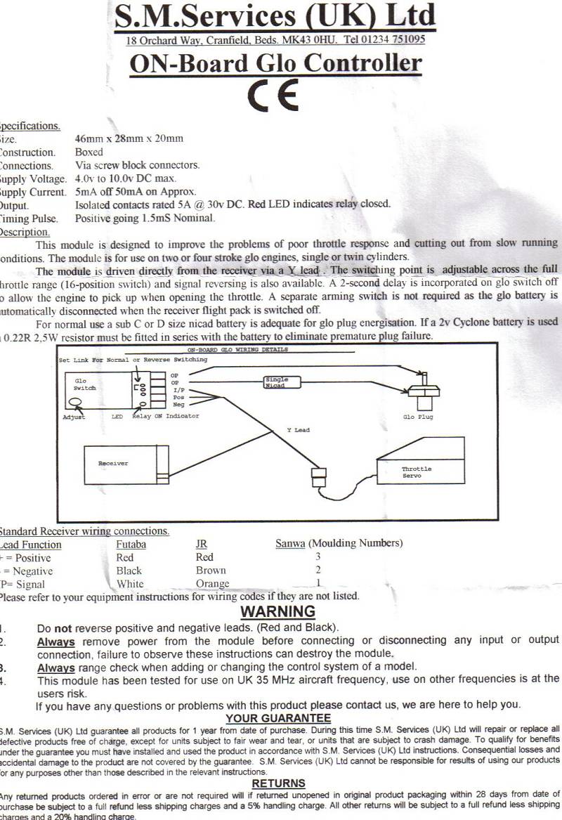

I have an enclosed cowl and need to use a remote glow head lock. Any suggestions on a good one?

Dubro has one as does Sullivan....I'm partial to the Sullivan as long as I don't have to change plugs

I have used this one for some time. It allows me to set ignition to the throttle. For example, I usually will have glow plug lit when I move throttle below mid stick. It connects to receiver so when I shut power to receiver it shuts power also from battery to glow plug.
