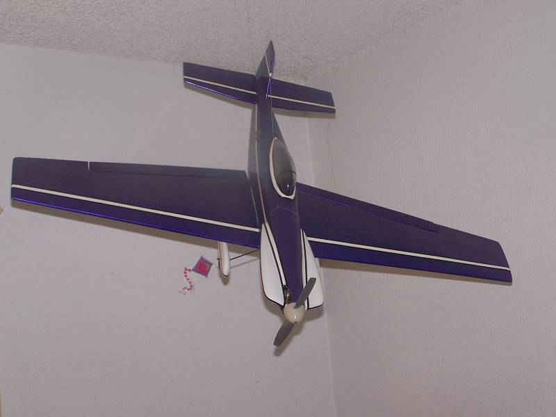

I'll try to post a pick of a scratch built plane that my Dad built years ago. I'll take a pic & post it for ya tomorrow if I can.

As promised, here are some pics of one of Dad's scratch-built racers. No plans, no magnetic building system, just some wood & a plan in his head.
