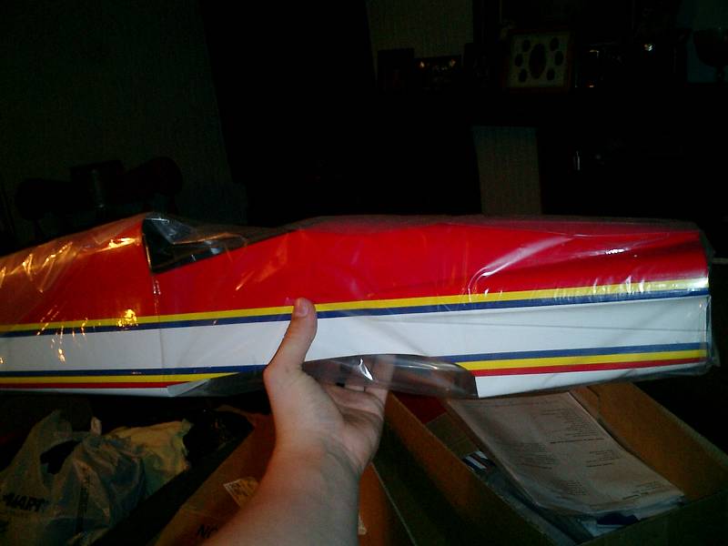

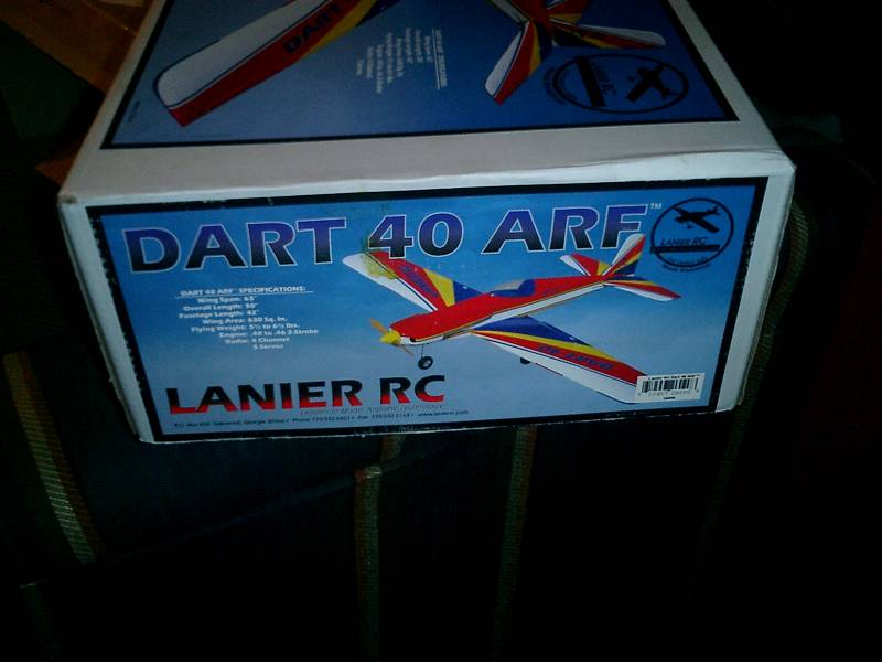

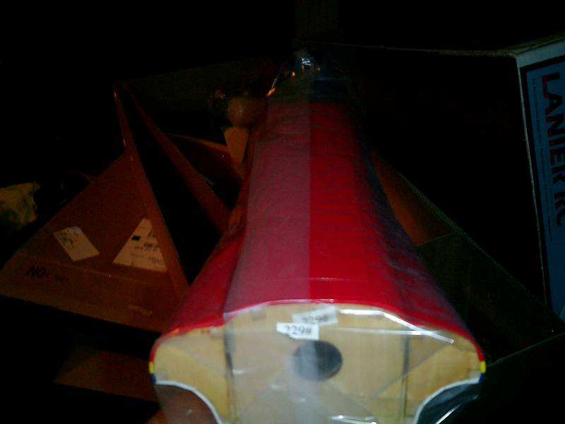

i won a new dart in a contest here it is,in all it's glory im so exited about getting it going.

EDIT:would anyone know how this plane might fly.Is it fast,really arobatic,can it knife edge?

LUCKYYYY! Looks like a low wing aerobatic trainer... Good second plane. I would not expect any hot knife edge action out of it unless you master the stunning manouver known as the "falling knife edge" This is where you put the plane into a knife edge and as it is lossing altitude you simply roll out of it as low as you dare. Far more spectacular in a plane that can hold a knife edge where you do the same thing but instead of rolling out you power out maintaining the knife edge neutralizing the decent mere feet off the runway.

Nice plane. It's like 220 on tower. My guess is that if it can be a quick pattern like flier. As for aerobatics it probebly will do well. The regular spins although not flat, snaps, rolls, loops, and an ok knife edge that will require alot of speed. I've never seen this plane before but this is my guess based on it's looks and a quick look on google.

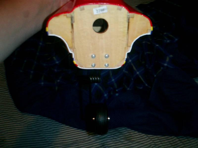

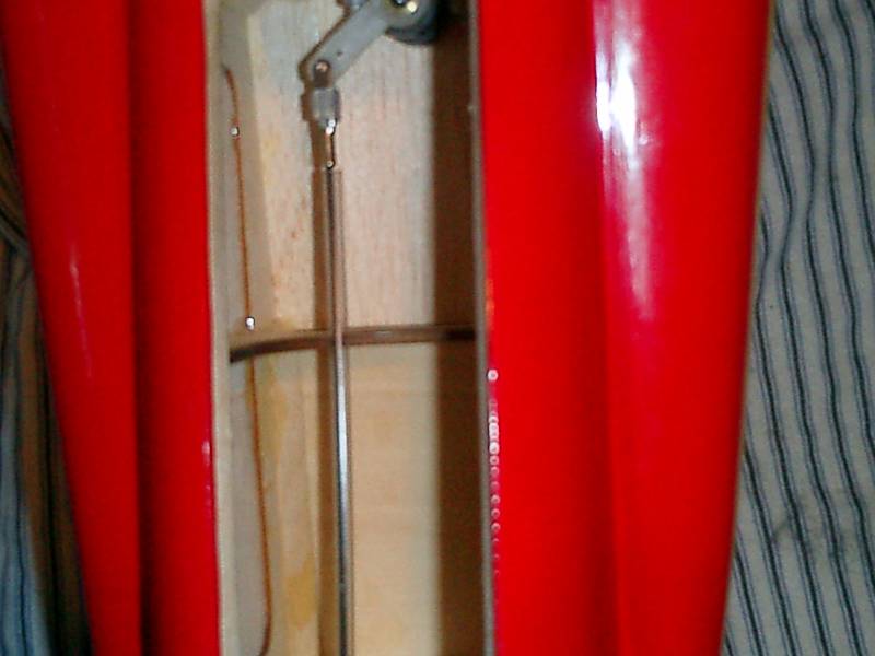

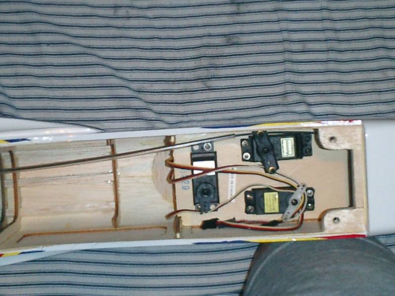

Progress from last night....

Wow they really changed the plane alot. My plane is a simple wooden structure inside the plastic fuselage. The wings are foam core and covered with Lanier 'Aeroskin'. The plastic on mine is prone to cracking out, and I'm probably going to have to retire the plane after this season. I also converted mine to a tail dragger. Are your tail feathers balsa? If so, you may want to consider adding to the rudder, as I know the stock one is pretty small. With the tail plane on the thrust line, this plane will knife edge very well, with no coupling. Mine is so good, I take off, and go into instant knife edge just a few feet off the ground.
