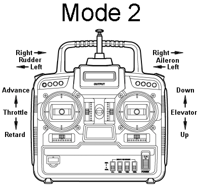

I would like to know what the proper or standard setup would be for my radio sticks right and left, for elv. rudder, alernons and throttle? Thanks

Most people in the US fly what is called Mode 2. That means the sticks are as follows.
Left stick
Forward-Backwards=Throttle
Side to Side=Rudder
Right stick
Forward-backwards=Elevator
Side to Side=Ailerons
Ken
