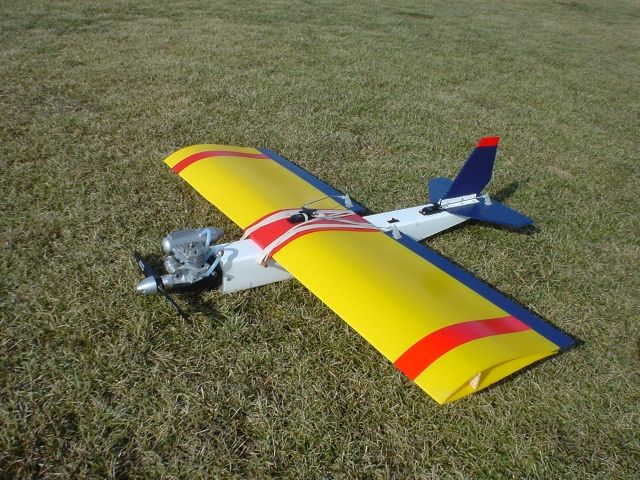

You could build a hand launched, belly landed SPAD. I did most of my learning on this plane...
