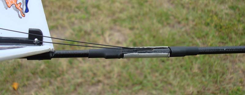

Here is a "pre-break" reinforcement using a short piece of 1/4" x .014mm aluminum tube cut open and glued directly on top of the existing plastic support.
