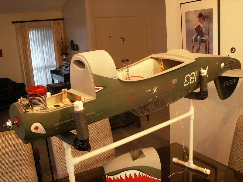

I have a MVVS 1.60 gasser in mine. It flies very but lands a tad fast, which is not a problem for me as I also love flying the Gee Bees. I did not use the engine mounts that came with the kit however. I simply mounted it directly to ply platform. I did have to open the front a bit to accommodate the ignition pickup.
