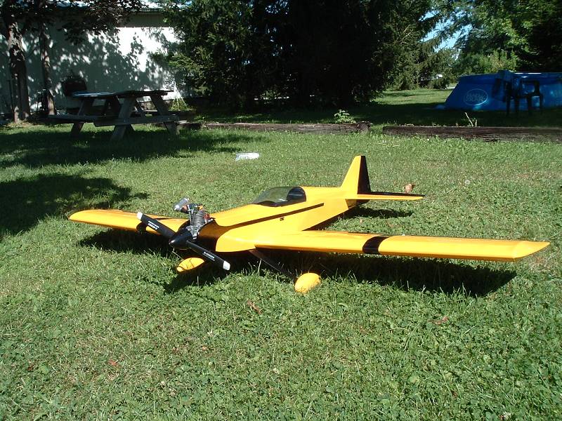

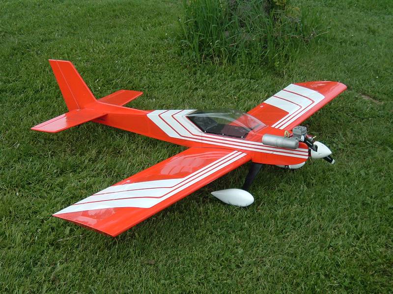

On my Venture 60, to taxi, I just use full up elevator. On takeoff rollout, I need only go 10' or so holding up elevator, by then the rudder has good authority. I use a Saito 91 for power. I just had it out this afternoon. This is a super flying aircraft, very honest and easy. There really is no reason for flaperons, I tried them with mine, just not necessary. Fun to play with, but this thing really can't use them. I do use them on my Tiger, they have more effect on it. I have the Tiger a little nose heavy, and it wants to land with some speed. The flaperons will slow it somewhat. I can't think of any reason to use flaperons in the up position. The reason to use up elevator is to allow more pressure on the tailwheel and getting more positive slow speed response. You will have a lot of fun with the Venture. Be careful you don't have uncontrolled fun, like my friend did with his. Still rebuilding it from last week....[:@]
