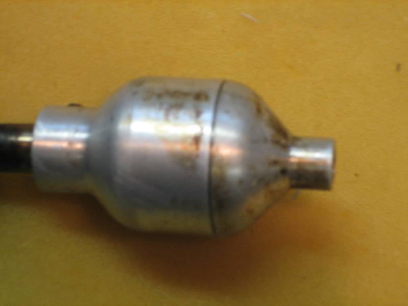

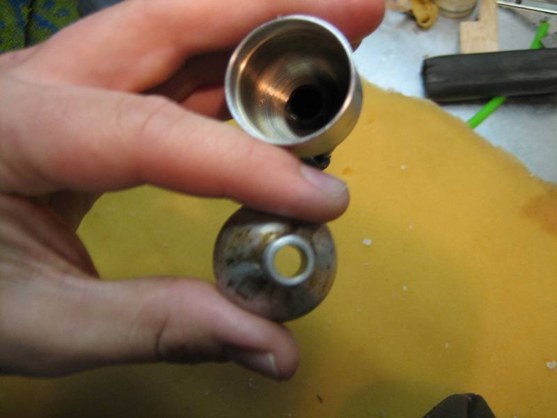

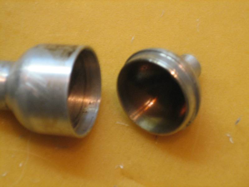

As you can see there are no bolts or lock nuts, and that rim in the one photo is NOT a thread but a rim to stop me from closing the muffler too far.
Please help me, thanks, dave trimmer

Dave,
Thanks for the pictures. You have a broken muffler. Those two halves on a YS muffler are usually welded together. Short of having those welded together I would recommend that you try using JB weld to hold the two halves together. If that doesn't hold it then you'll need to get a new muffler for your engine.

Dave,
As I read through the other posts Aerowoof's would help. Put 2 or 3 small screws there the muffler, and then JB weld it in place. That should keep it secured.

Carellh has the best idea,welding alum. is a art.a TIG welder is a special type of machine for welding somone who repairs aluminum parts would have one.
without a photo of what you were talking about there was alot of missunderstanding about what you were asking, the link you provided was for the new YS engine, with the new style muffler, with jamb nuts, and a screw on muffler hence the confusion.if you have a small tap drill a couple of holes in the lip and thread some small machine screws in there.
the JB weld says its good to go for aluminum, the stuff is pretty strong and rated to 600oF you might not even need screws .
