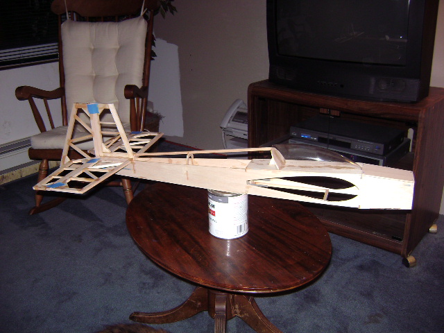

i'm building a 40 size dazzler kit. anyone have one of these and just wondering if anyone has made mods to this plane to make it better? the directions and materials are really good so far and the build is going well.

I had the Dazzler ARF powered with an OS 50 SX. I utterly destroyd it. However Looking back, it flew a lot like a smaller version of my Sig Something Extra with a few exceptions. I can pull a knife edge with my SSE while my old Dazzler would fall off of a knife edge so side force generators or a modified rudder might be in order. Your only limits are your own imagination. Also the area of the fusalage on top about 1-3 inches back from the leading edge of the wing is thin and should be reinforced as this is where it will break after a hard landing.

yep....i thought that area of the fuse was going to be the weak link of the project. i'll have to give that area some special attention i guess. did your wing come off for ease of shipping to the field and back? this one is all put together and stays that way (unless you smack it....lol). it think it's going to be pretty col to play with. but thats cool that someone had one of these. thanks for the come back. i'll let you know how she goes. thanka again!
