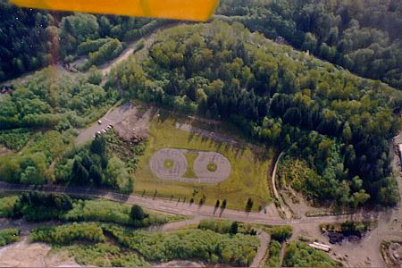

I had an 46LA on my LT40. At our field, you have to make a climbing turn immediately after take-off to get up over the trees... (in the picture I've attached you can just see the runway in the centre of the picture under the shadows of the trees)... the 46LA made take-offs a little more "interesting" than was really wanted! The 46FX made things a lttle more comfortable... I'm not knocking the LA mind you..I've still got it(on a smaller plane)... it just wasn't quite enough motor given the field/airplane/my skill level combination.

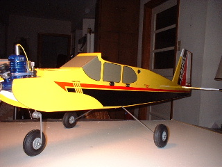

Thanks for the positive feedback on the 46LA engine. I won't hesitate to install it in my LT-40.
Crashngo, I like the looks of your LT-40. Nice pic. Great colour scheme that I may have to copy! Cheers.

SIG LT-40 Trainer and O.S. 46LA
Hi Bill,
The Yellow is easy to see, however the bottom checkers are only 1/2" squares and they tend to look like a dull yellow grey when it is up in the air more the 30' or so. The checker pattern is so small it just all kinda blends together when at any sort of altitude and moving along at a good clip. It does look nice when doing slow fly-bys...
-Fitz.
-Fitz.
Wondering if its best to just do the bottom wing in a different color than the top for better orientation. Thought the checker pattern would be a good way to go. Still a nice looking plane Fitz.
Bill.
