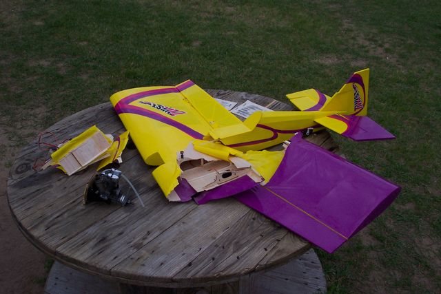

And No, don`t you dare fly that SSE till you got that trainer down, or it will look like this. lol
