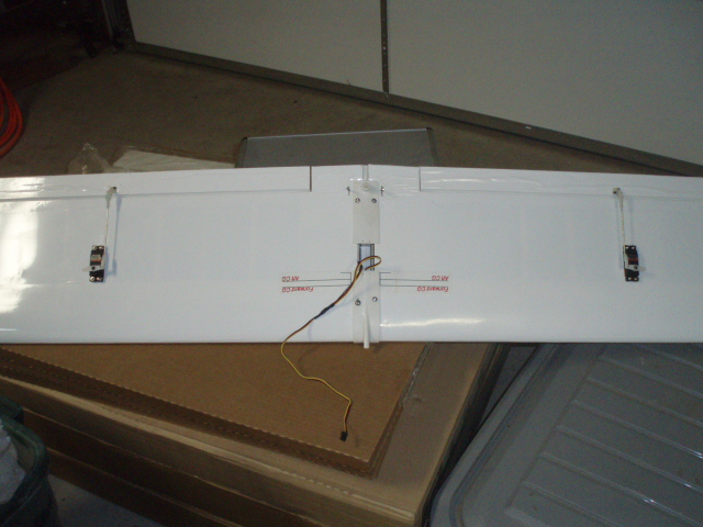

I plan on picking up the Hobbico NexSTAR 46 Select 4-Channel RTF 68.75" to use as a trainer, and i have been browsing through its manuals, ect. I came across this tidbit.
Now, correct me if im wrong, but i believe the ailerions are on the wings that control the banking of the plane though its center axis, (the axis from nose to tail) And i am just curious as to what exactly would be on this plane now, and also what difference a "dual aileron" servo setup would do.

You are correct the ailerons control roll about the 'longtitudinal axis' and what that statement would indicate to me is that in addition to the mounting provision at the wing joint for a single servo to control the ailerons through pushrods and torque rods on the ailerons, that they have also provide mounting plates out on the wing bottom somewhere to instead of using a single servo but use one on each wing operating the ailerons through short pushrods directly to control horns on the surface.
On a trainer in the training evironment they provide virtually nothing. For aerobatics they tend to remove some of the associated spongeness of aileron torque rods and will provide a little better roll control.

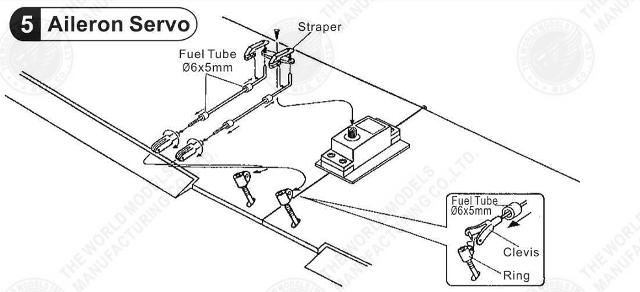

Just to add, I have attached a picture of the servo installation from my world models Frontier 40 manual. Although this is not the same model, the installation is similar for most types of trainers. As you can see the installation uses one servo that is connected to both ailerons through the use of torque arms. This is more than sufficient for most trainers such as the NEXTStar 46 as you do not need the extra power/torque and rigidity provided by two servos, in fact there are even some sports models such as the Word Models Mach II that use this set up. The only reason a beginner would need two servos in a trainer such as the NEXTStar is if one wants to experiment with flaperons (this is when the ailerons work as flaps and ailerons at the same time). You will never need flaps in a trainer, but some people like to experiment. When it comes to the extra rigidty and power of two servoes, as a beginner you will never be able to tell the difference between a one servo or two servo set up. I doubt that any body besides the most advanced pilots would be able to tell the difference in set up between a one and two servo set up in a trainer.
I am not to sure what type of radio the RTF version of the NEXTStar comes with, but if you want to experiment with flaperons you will need at least a 5 channel radio with flaperon mixing built in (their used to be some after market devices that could be fitted to the plane that could do the mixing but I am not to sure if they are still available).

wings are built with dual aileron servo trays for future upgrades as skills increase, This suggests the wing has a couple of servo trays hidden under the covering out on the wings. The idea is that in the future when your skills increase, you may wish to retrofit the wing. You may wish to pull the single servo and stick in a couple out in those hidden trays. My advice is that when you've worked up your skills, you'll want a more agile airplane. And you'd rather put two servos into your next airplane. Like in a Calmato Sport for example.
