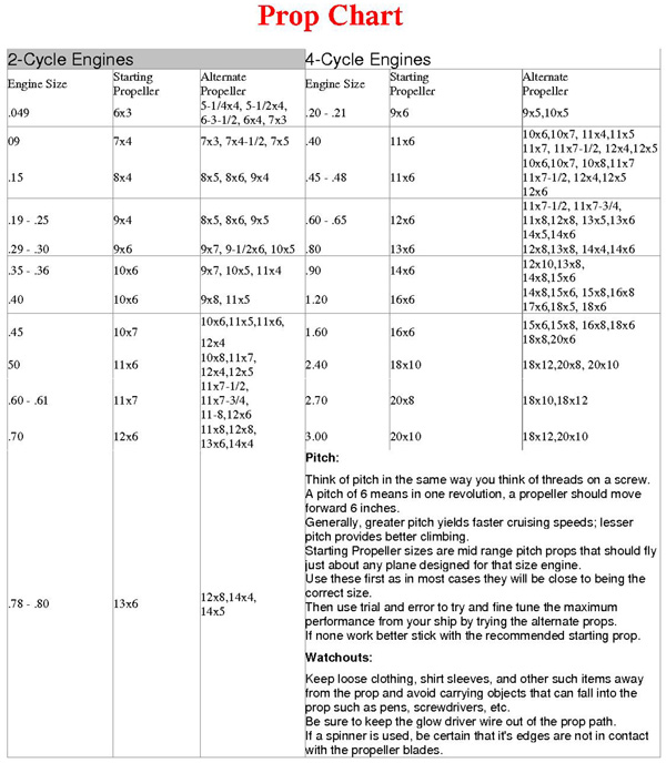

You can find a range of props for that engine. It all depends on what performance you want. Smaller pitch props (the second number in the prop size) will usually cause more RPM. So, you will have to watch that so you do not exceed the max RPM for your engine. It is not unusual to get 12,000 RPM out of that engine when it is running correctly and correctly prop'ed.
Think of the pitch as changing gears in your car transmission. Lower gears relate to lower pitch numbers. You get more power, faster acceleration, higher RPM, but less speed. Higher pitched props will give you less power, slower acceleration, lower RPM, but higher speed. But, at limits. You cannot, for instance put a 15-10 prop on a 46 sized engine. It will run, but you will never get the thing off the ground.
