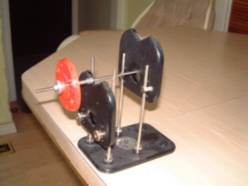

I haven't yet figured out how to mount a spinner on a balancer since all the spinners I have used had no thru hole.
Old 06-29-2007 | 02:30 PM
-pkh-'s Avatar
Joined: May 2004
Posts: 3,354
From: Emmaus, PA
Default RE: Spinner opening question
If you get the [link=http://www2.towerhobbies.com/cgi-bin/wti0001p?&I=LXD712&P=7]THIS[/link] Dubro balancer, you don't need a through hole on the nose cone of the spinner.
You just set up the balancer like this:

pkh, i can't see the pics []

Here you go...
ID:	713860   Click image for larger version
Old 06-30-2007 | 11:57 PM
Joined: Mar 2007
Posts: 179
From: Little Rock, AR
Oh now i see! Thanks for the pics pkh!

When I do it, if it's plastic I use a knife.
Take a bit out of one hole wherever you think it's needed. Then go to the other side and take the same amount from the same place. Check the fit. repeat..........
Once the holes are large enough. Check the balance on a balancer. Balance the backplate first. This bit needs care. You need that backplate right, because then it won't matter what it's orientation when you're checking the cone's balance. Cones seldom take much effort to balance unless you've had to open up the prop holes.
Once that's sorted, if any "whittlin'" cuts need smoothing, do that and check the balance again.
It is worthwhile to check a spinner's balance. You don't have to get that or a props balance absolutely perfect, but it does matter enough to get close.
