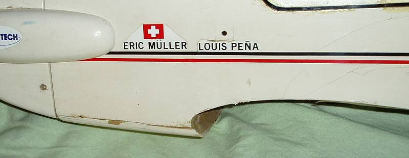

I have a CAP 21 plane made by Model Tech (.40 - .60 size).
It appears in ok condition - it is dusty though and it has some cracks in the surfacing (not sure if they are structural cracks or not) but the surface is made from some kind of painted fiberglass material.. (not sure what it is really)
It has an SC .61 engine to go with it.
I am just wondering if the cracks will stop it from flying correctly and also I need to know where to mount servo's, petrol tank etc.. I have no instructions.. is there anywhere that I could possibly get a set of instructions for one of these so I can make sure I have everything correct before attempting to fly it?

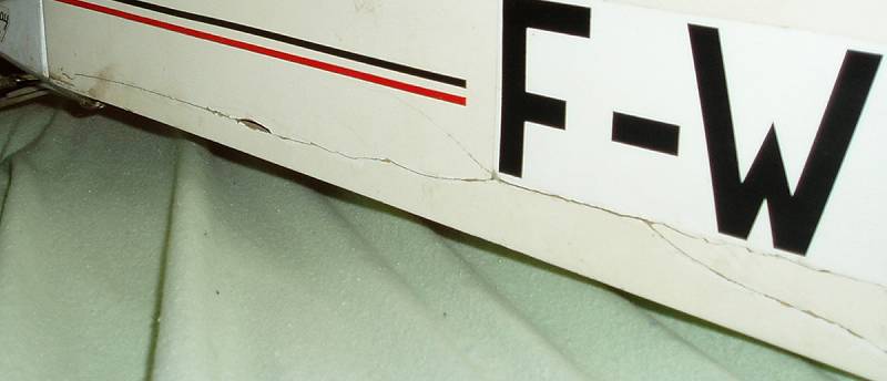

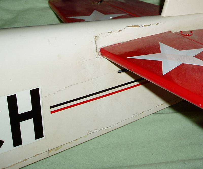

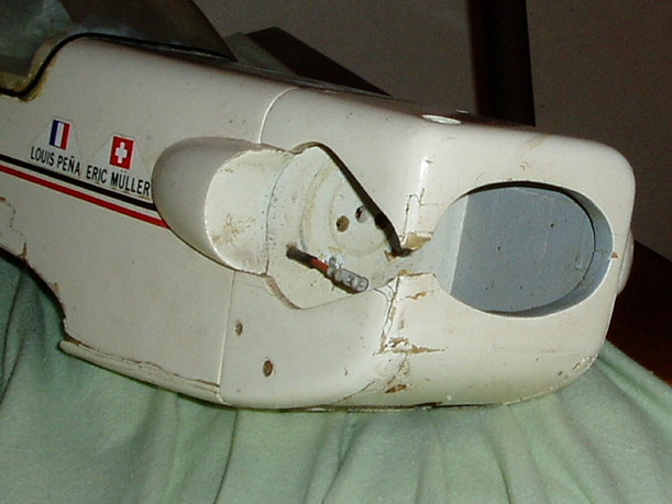

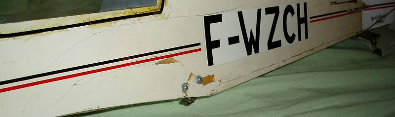

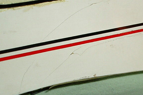

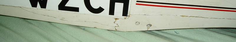

Pics of cracks
The plane feels structurally sound but I haven't attempted to fly it yet..
Any help would be greatly appreciated! Especially Instructions!
KJ =)
KJ =)
Some of those cracks, especially the ones along what looks like the top of the horizontal stab could be cause for concern. One thing you don't want to lose while flying is your horizontal stab. You may wish to have someone more experienced take a good look at this fuselage to make sure that these are not structural in nature.
If these are just surface cracks, well, perhaps a little repair, some covering, or just leave them alone.. and give it a try. But be careful.
Don't just think 'well, if it crashes, well, so what' because that could cause you some severe heartburn. The what if.. could be what if it does break apart in flight and hits someone on the flight line? Then what would you do? Losing the horizontal stab during flight means you have completely lost control of that aircraft and where it is going to go next.

Your not going to like hearing this,but DO NOT fly this plane untill you strip all the paint off it and re-glass the entire fuse! The fuse has been glassed,and all those cracks are structural fractures and breaks and need repaired. By looking at the pic's,the plane was painted not covered in covering,and sustained a severe crash to crack all the paint,wing hold down blocks and stab hold down blocks. Crash was most likely due to the infamous Cap-Snap on a take off.Repair the plane completely,then remove the main landing gear from the wing and place them in the fuse about 1 inch in front of the wing.This simple trick will stop the cap from snapping on take off only because it forces the cap to only lift it's tail off the ground when it is at it's true and actual flying speed. The Cap is a fantastic flying plane when set up correctly,i used to have 3 of them at one time,but thinned out my plane numbers over the years. Fuel tank goes in fuse just behind the firewall,reciever goes just behind the fuse former at the wings leading edge where the wing goes into the fuse,servo's ( throttle,rudder,and elevator) go into a tray located just past the mid-way point of the wing saddle,and aileron servo is located in the wing it's self. CG of plane is located between 3.5 to 4.5 inches back from leading edge of wing at the fuse with the plane inverted. Hope this information help's you out!

I don't think this plane was fiberglassed. Looks like they doped the wood and then painted it. Without Dacron, that finish would crack along joints very easily. And then some of the scars look like crash damage. Wiggle everything and see if anything moves. The plane is likely air worthy.
Snap21's were nasty, ill tempered planes that bit many a pilot early on. But they can be tamed. Limit the elevator travel. Crank up the ailerons slightly to reduce the tip stall tendency, and add nose weight. You can never completely remove the snappy tendency of these planes, but you can improve thier personality with these few changes.

The wings are in great condition. the plane overall seems structurally sound, I applied a firm pressure to all the area's with cracks and it all seemed strong enough, but is strong enough to fly? I am not sure.
Just for looks I would like to fix up these cracks anyway.. what is the best way to repair over the cracks and achieve that glossy plastic look that they have used from factory?

THe old way of finishing models, and it still works great, was to paint the wood with a product called dope. Dope is a thick, but very light weight , clear substance, that dries very quickly and allows the grain of the wood to be made perfectly smooth. Typically, two or three coats of dope are applied. Then Dacron, a man made cloth similar to silk is applied using another coat of dope, or other adhesive. Then the weave is filled in with another few coats of dope. And the whole thing is then sanded smooth with 400. Its fast, easy and allows a great paint job to go on top. Actually, they even sell colored dope, so this would complete the project.
It appears , that your man only applied dope before painting. He didn't apply silk or Dacron. So the plane has no "hide". A fingernail could easily be depressed into the finish and the vibration and stresses of flight often cause cracks to appear in the finish all along the structure. Many of the cracks in your pictures appear to be the result of the technique in which the modle was finished. And a few appear to be the result of a minor crash. He might have used a product called silkspan. Its very much like tissue paper. Its great for small models. But doesn't offer the strength needed for an aerobat of this size.

Wow, that a lot of info! sounds complicated but I guess it can be achieved!
So this will fix/repair the cracks and have the plane back to a safe flying state then?
Thanks for your help,
KJ :-)

Be cautious, you do not know what kind of finish is on your plane.
Different types of finishes may react with each other and cause wrinkling or who knows what kind of reaction? Try you new finish in a small area first.
There has been a trend in recent years away from Dope with the use of Urethane paints and in particular of using spray enamel for color and then using Polyurethane clear over the top as a fuel proofer. Therefore your plane may not have dope on it?
I personally have not used dope in 20 years. But I used to think I couldn't live without it.

I rather doubt the top coat is dope. And dope might react poorly with it. I'm afraid that a quick coat of dope is not going to repair those cracks in the paint. I was simply trying to explain the possible process that the builder appears to have used to paint the plane.
I suspect the top coat is not dope. Therefore, you could 1.) try sanding everything off, and starting new. 2.) sand everthing off and then use iron on film, 3) fill in the cracks, shoot primer, sand and then repiant it. But if my assumption is correct about the builder not using Dacron or some other fabric, your paint job could easily show stress cracks also within a short time.
I would suggest that you simply fly the plane as it is now. Those cracks are hard to see at 60 mph and fifty feet away. Then maybe some day later you can give the plane a proper restoration.
