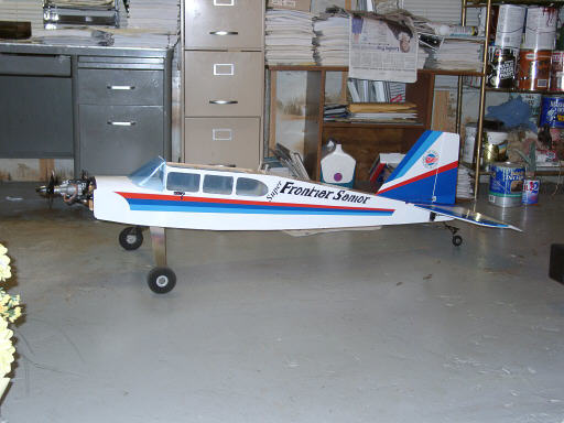

I am the person at our club who does 90% of the training for new pilots and there is one plane that consistently proves to be the finest giant scale trainer I've ever flown. The plane is the Senior Frontier by World Models. It lands so slowly and is very hard to stall on landing. With a 80" wing, a .65 four stroke or a .70 Surpass is a fantastic match. I'm attaching a couple of photos for you. Quality is outstanding and easy to put together. The guys who are familiar with the Senior Kadet will recognize that same configuration. This plane DOES have ailerons, though. Have fun!

Ditto on the Senior Frontier! But I like the taildragger version better!
I still want another one. I would love to use it to pull banners.....
KD4VCU

Default giant trainers
Magnum,
Both of you Guys Senior Frontier looks great.. Can you put a small gas engine or is it too light..If so, what Company would make such a small gas...Pete
Old 03-09-2002 | 11:22 PM
magnum's Avatar
Joined: Nov 2001
Posts: 357
From: Huntsville, AL
Hmmmm..
Looks like I misread the original post. I thought he was looking just for a giant trainer....
I don't know of any gas that would work in this plane. Mine had a 90 Magnum fourstroker and I still had to add weight in the nose.
I would be afraid a gasser would shake this thing apart unless you pinned the firewall and or glassed it. PLus, you are correct it is just way to light.
