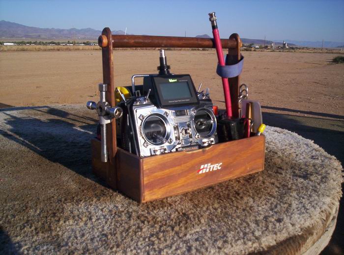

BTW, I'm editing in a picture of my flight box showing the fueling setup I use. Hand crank pump. The fuel jug is a thick plastic one I found at a kitchen store. There are only two lines in/out of it. One is the pickup and goes to the pump. The fueling line from the pump plugs into the vent when not in use. In use, I unplug it and the jug is vented. The hose nozzle is from one of the fueling sets for models. The piece you're supposed to stick on the model's cowl is the vent in the jug. None of my airplanes have that expensive stuff on them. It's on the jug and fueling hose. The airplanes are fueled through the hoses from the airplanes tank. Just disconnect a hose, fuel through it, connect it back. No cost. No extra building effort.
