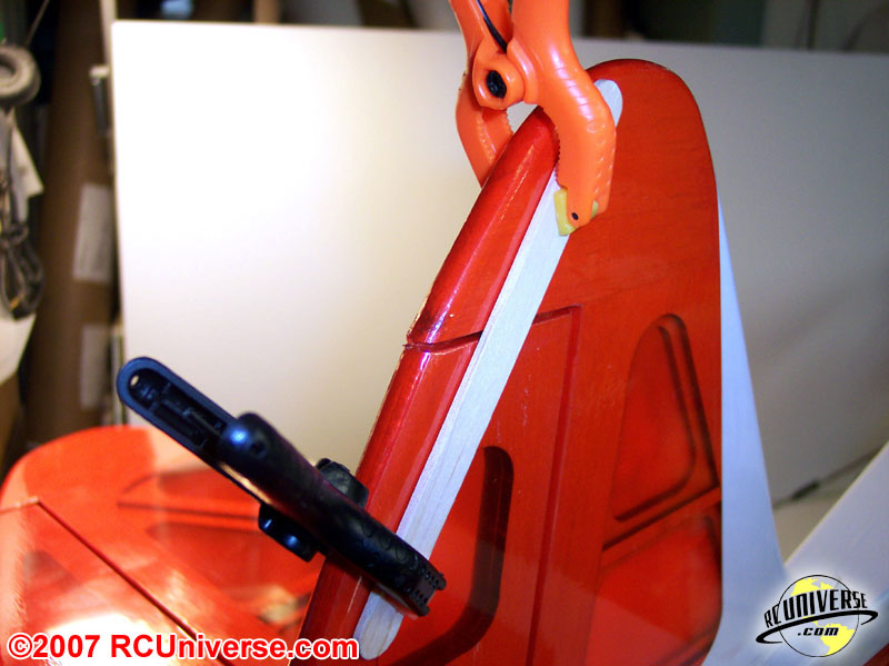

i use clamps on the horizontal and align it with my eyes and a triangle. I use epoxy to glue major sections like this in place. for the vertical stab after the horizontal stab is dry. I use 2 triangle placed on either side and run a piece of masking tape from hor stab tip over the top of the vertical stab to the other side and secure it to the other hor stab tip trapping the vertical stab (rudder) in place. double check with triangles to ensure the vertical stab is at 90 deg. I'll leave the triangles in place while the epoxy is curing so I can glance over to make sure I'm staying true.

What I do is to start with the stab (Have the wing in place). Use 30-minute Epoxy. Put the stab on (without the epoxy) and check it visually with the wing to make sure it will line up. Sand the stab saddle if you need to.
Once it will line up with the wing, epoxy it in place, recheck the allignment (From top and rear) and once you're sure it's right, add a drop of medium CA in a few strategic places and hit them with accellerator to hold the stab in place while the epoxy cures.
After the epoxy is firmly set, use the same technique on the fin.

Ok, I'll go into a little more detail on the stab:
As I said earlier, mount the wing.
Now put the stab in place - measure both sides to make sure it is centered, and measure from wingtip to stab tip on both sides to be sure the stab is not cocked in the "Yaw" axis. (Note: if you don't have a long enough ruler to reach this, you can make due with a scrap stick. Even gluing a few scraps together will work, but DON'T use a piece of string. String can stretch and give you an inaccurate reading)
With the stab aligned, "Eyeball" from the back to make sure it is aligned horizontally with the wing. If not, sand the stab saddle and repeat the previous 3 measurements.
Once it all lines up, put it in place with 30-minute epoxy (You'll need the working time)
Repeat the 3 alignments steps again. (I never said this was going to be quick) You can use small slivers of scrap balsa to shim the stab horizontally if need be.
Once it is aligned to your satisfaction, you can do one of two things. Either walk away slowly and re-check it ever few minutes to be sure gravity didn't make anything settle, OR add a drop or two of Medium CA in certain areas and accelerate them to hold the stab in place. THEN walk away slowly and re-check every few minutes.
Don't just think that once it is aligned it will stay there! Keep checking for about 20 - 30 minutes until the epoxy has started to set.
I do not recommend using pins!! The force of pushing a pin through the wood is more than enough to knock things out of alignment.
After a while, the epoxy will be set enough that you can leave the room to have dinner, beat your wife, watch TV, or whatever else you had planned, but don't touch the plane for at least an hour or two so the epoxy really has a chance to set.
