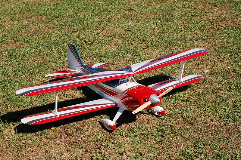

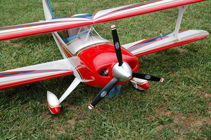

I'm running a 13x6 Top Flite wooden Power Point on my OS61FX powered Skybolt. The Skybolt is the ARF that is only a shade over 7lbs. The prop worked better than the APCs and Master Airscrews I tried. All are good props, this one just was better. I've been trying different props since completing the airplane last year. Can't count how many have been on the sucker. And the 2nd best prop has been a 3blade 12x6 Master Airscrew. Darned if everyone always bleats about "efficiency", but the OS/Skybolt hasn't listened.
