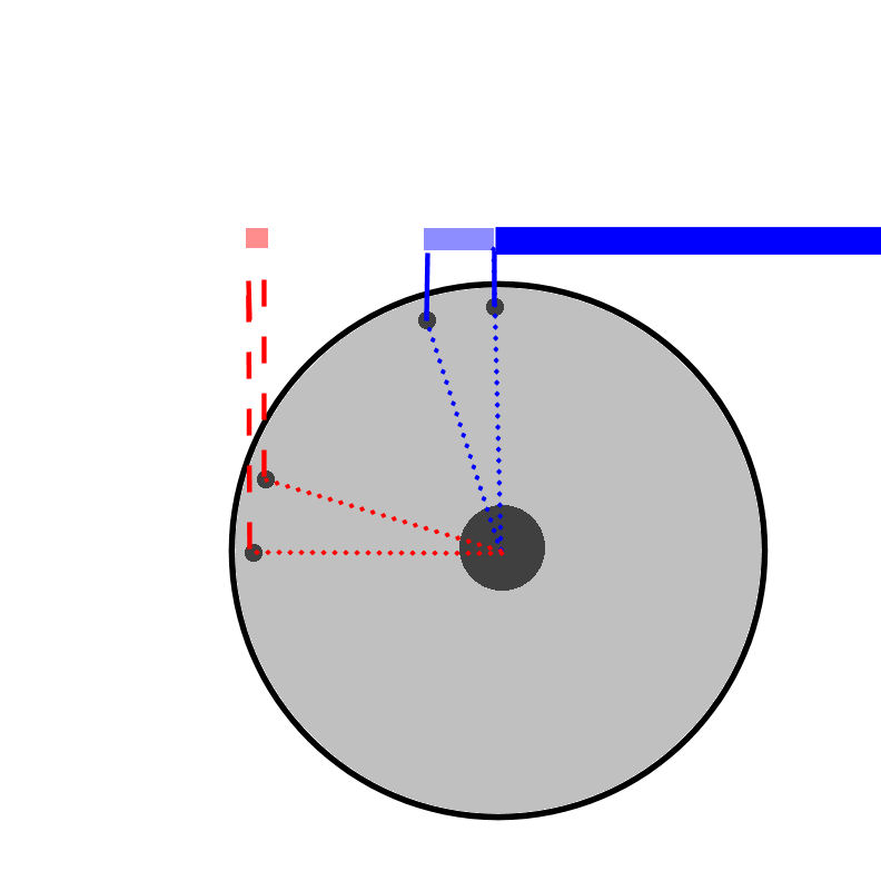

Here's how the servowheel-to-pushrod connection changes the movements from linear to non-linear.
However, the motor response is to the amount of the throttle barrel opening and closing.

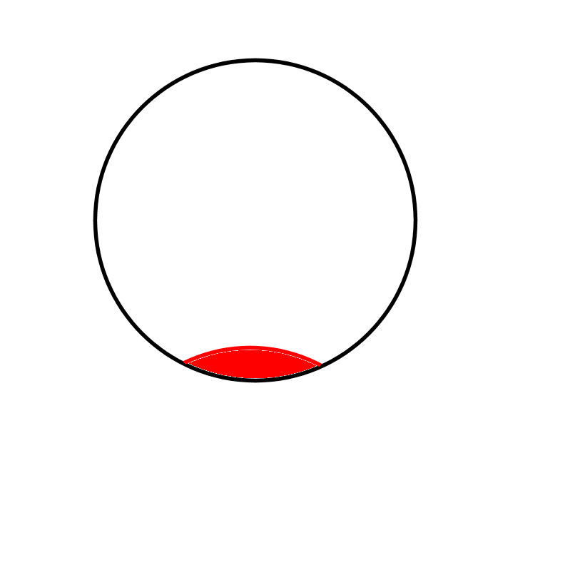

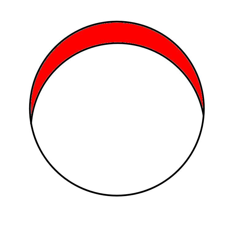

Here's what happens inside the carburetor when the throttle stick is moved about 15degrees from fully closed.
And beside that is the carb opening when the stick is moved from full open by about 15degrees.
The same stick movement gives very different openings because of the geometries of the parts in the carb.

Always setup your throttle servo arm and carb arm to use only about 60-80degrees of arc. And make sure that when your throttle stick is centered, the throttle servo is centered and the carb arm is centered. And you want the pushrod to be 90degrees to both.
If you setup the throttle system that way, you'll minimize the rotary-to-push-pull problem. And in fact, the two characteristics shown above will actually sort of cancel each other out.
