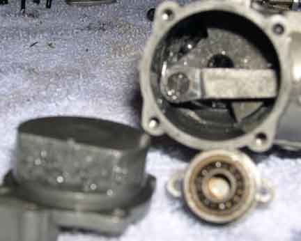

Hey Guys,
Got my H9 Solo Sport all ready to fly again since the wing needed balanced and then recovered and with that fixed right, I hope.....I went out early Sunday morning with no one around for some fun!!! I got all fueled up and ready and started her up and finally took off. So far so good...this plane is flying level now and doing great! I love it when it all works right...then about 10 minutes into the flight the engine just died. Ok..fine, dead stick her in then and thank goodness I'm on the approach turn anyway (lucky!). I come in sweet but a little faster then most times and she settles down after two small bounces with no damage or a broken prop. I took her back to the pits and got her ready for another flight....in doing so I noticed the engine wouldn't turn at all! Hydrolock I thought, so I removed the plug but still no movement! [
] I got home and took the engine a part and found a lot inside....I guessing it's from the wrong fuel or the cam bearing dried up and sent metal threw the engine or the piston ring came apart. You can see the blurry engine pic and the fuel bottles I used....clearly one mistake since one bottle says it's for 4 stroke engines and the other doesn't but both say 15%. The color is even the same! Now before this last flight I noticed the engine seemed hotter then normal and the exhaust had a grey ting to it which went all over the plane...it wasn't the simi clear oily mess as before. Now this engine has been put threw the ringer being on all my planes so far which means several crashes but what do you guys think? And why isn't that cam bearing sealed anyway? I've got to get another engine and wouldn't mind getting another Magnum 61 fs if I can.

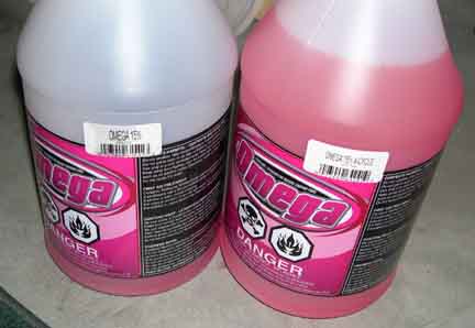

It says 15% on both jugs of fuel.....is that not enough for most 4 strokes? Moister in the bearing....never thought about that! I bet that got in there at some time, next engine I will make sure that bearing gets oiled more.

i think he meant 15% nitro. but still it would have plenty of oil. i'm assuming that is a 2 stroke. never looked inside a 4 stroke rc engine to know what they look like. i dont know the differnce b/w 2 and 4 stroke fuel. if i had to guess the 4 stroke would have a little more oil because of more moving parts but i could be wrong. i'm sure someone will chime in that knows more about this than me. but i just always stick to 2 stroke fuel with 2 stroke engines and when i get a 4 stroke i will just stick to 4 stroke fuel with 4 stroke engines. but moisture could have gotten into your bearings and rusted and when they got broke loose from the starter and ran a little while all that rust ran through your engine. that greyish color you saw was more than likely metal shavings. which was probably from bearings and other stuff grinding down. i've had several bushing engines lock up on me and i had a silverish looking oil instead of dark brown/black oil on my planes. i'm sure there wouldn't be that much differnce. metal shavings are metal shavings.
This is the primary reason I don't like Morgan fuels. I can't find any information on how much oil they formulate. Are you sure the 15% you quote is oil content or nitro content?
If it is oil content then I'd say no, 15% is not enough for a 4 stroke.
What does your engine manufacturer recommend? I just acquired a Saito .62 and, while I don't have the manual in front of me, I believe they recommended 20% oil content. After it is well broken in you "might" get by with an 18% fuel content but ONLY if you run it carefully.

i just looked it up, the omega %15 has %17 oil, which is a little low, but shouldn't have coused problems, and the 4 stroke also has %17 so i don't think it was lack of lubricant, it might have been running too lean

I've seen bearings that were so rusted they stopped moving and started to flatten on the exposed side, spewing metal shavings all over the crank case. I think people put way too much emphasis on exact brands of fuel. As long as you buy a quality well known brand, set the engine correctly, and use quality after-run oil you should be fine (400+ running hours). In fact, I have a few old (no longer made) engines that probably have more running time than that and still run like new! Two-stroke fuel runs four-strokes just fine, although some four-strokes like more nitro content.
Set your mixture at least every time you go out to the field. On my high performance engines I usually reset them as the temp/humidity changes even if I've already set it for the day.
the grey oil at the start was a sign of metal to metal wear.most bearings failure is caused by rust which in most cases is the result of fuel left in the engine.alchol left in the engine will absorb any moisture in the air and after the alchol evaporates the water is left to cause the damage.nitro is also a contributing factor as it is a derivitiive of nitric acid and a corrosive and has a tendency to remove oil residue before it evaporates.this is one of the reasons for running your engine dry at the end of the day and what started the use of after run oils.
I have gone through 7 or 8 gallons of Omega fuel since I started flying without any problem at all.

Ok guys, I won't use the Omega anymore and since I bought a new Saito 62 four stroke and the hobby store owner said that all he uses in all his four strokes is Magnum fuel. Has anyone ever used that?
