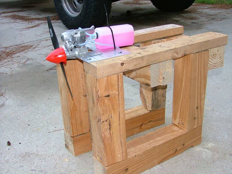

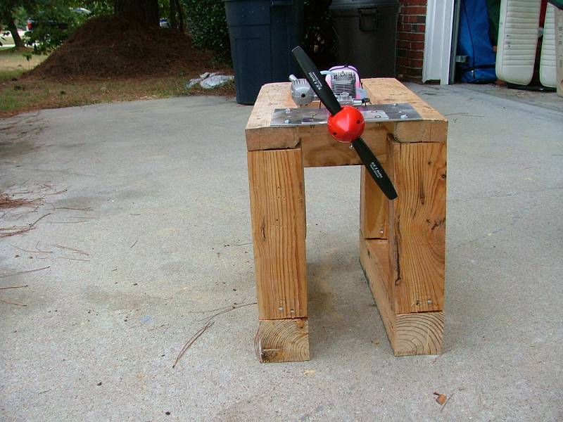

I'm sure most of ya saw the post on the redneck test stand. I do recall that it had some Machined/purchased parts in it. well i made one the other day out of the scrap lumber i had laying around and a couple aluminum plates. Granted it is 7075 T-6 Aluminum, but i grabbed it out of the scrap bin, so i think it still qualifies. I used some spare wire left from when i ran the electric fence for my throttle, no lever or anything, just hang on to the end and get fuel all over your hand. I guess in the spirit of spad engineering I did blow it and use a real aircraft fuel tank instead of a coke bottle like they did in the previous example, but no one is perfect right?
Looking back, i would have made it heavier or made some way to anchor it because i did have to sit on the back of it to keep it from walking around on the driveway due to the vibration when i had the engine "4 Stroking" due to the rich mixture during the breakin. I ended up smelling like i took a ride on one of my planes when i was done.
but i have about 4 tanks through this new .55AX now. it idles fairly well and consistant, and the throttle response is good already. Man this engine fired right up after i bottomed the needle valve and started from a good initial setting! I have a good feeling about this little beast already.
anyone got any reccomendations for a prop for this engine on a SSE?
here's some pics of the stand.
not shown in these pics is the block i added behind the fuel tank to keep it from vibrating back out of the ziptie and some foam padding i put around it to try to isolate it a little bit.

It looks significantly heavy to me.
Maybe putting some soft rubber on the bottom beams to get more square inches on contact with the concrete will stop the walking issue.

looks like you could mount a wet bar under that thing.i have an old cable spool that i use to work on my lawn mowers and such and have several universal motor mounts i fasten to it when i need to test/break in a new engine.

that's not a bad idea either. maybe use the engine being broken in to generate electricity to run the fridge for the bar! I like it. i was thinking about what to hook up for a test stand, and things like the cable reel came to mind, just didn't have any, and i didn't wanna hang it on the end of the workbench because i didn't want it spitting fuel all over the chevelle in the garage among other things, so that is how the contraption you see came about out of scraps of lumber left over.
