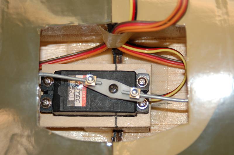

Hi, I'm just putting togther my first plane equipped with retracts. With the retract servo in the neutral position is it best to have the landing gear up or down?

It doesn't matter because a retract servo is a 180° servo. It only travels from one point to another, so there is actually no neutral point on the servo. It's either going to be at one end of it's travel or the other.

The servo for mechanical retracts works differently than other servos. It has two positions, up and down. It has no neutral. There are reasons they are like they are.
When one of them is either up or down, they do not draw current. And the rigging has them at full throw, so there is little or no leverage against the servo arms. They rotate 180degrees or thereabouts going from full up to full down. THEN they draw current.
Mechanical retracts are designed to complement those servos. The retract actually doesn't start moving the strut until the actuator arm has moved something like 15% of the total movement. The actuator arm is actually moved into a mechanical locking position when full up or fully down. The actuator arm does not have to hold the strut either up or down. The last 15% of movement moves into lock at either end of the throw. It all works like gangbusters.
Here is a picture of the retract servo in a Kyosho P40 Warhawk. It's a 46size warbird.

Measure the throw of the retract mechanisim. Lets say for an example the pushrod moves 1" from full up to full down and locked.
Get a servo wheel and space the two connections to that wheel 180 degrees apart and the same distance that you got from measuring, in our case, 1" apart and equidistant from center. If you have to use a blank servo wheel and drill a hole do that, dont use the holes on a stock arm that are "close enough"
That will give you perfect retract throw. MinnFlyer has a great diagram somewhere.

Do one side at a time and get it working and set right up and down before doing the other side. I have several planes with mechanicals. They work great when set up right. Those photos looks good too. Thes servos are not proportional. Cannot adjust the travel at all, strictly 180 degrees off.
Also take into consideration the rods you use. In the last few years I use 4-40 now because thinner rods can bow out. More stable this way.
