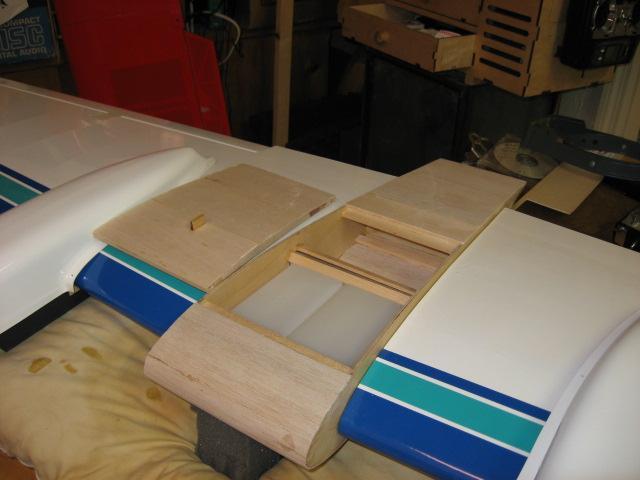

and one more...

Do you have any pictures or a diagram of how the tanks are connected? The exhaust tube is going into the fuselage tank. Then does the other fuselage tank tube go into the exhaust tube of the nacelle tank? And then the other nacelle tank tube goes to the engine? So the fuselage tank is pushing fuel into the nacelle tank through the exhaust tube? Is the nacelle tank set up like a normal tank, with the exhaust tube bent up or is it modified?

What problem do you see without valves? Low pressure only one engine running?
Old 08-27-2007 | 12:19 PM
  #31
Joined: Aug 2006
Posts: 128
From: palm bay , FL
Default RE: TWINS! - Any advice for a first timer?
if I held the plane up and the engines were not and the same leval the higher one got fuel starved (i think) and quit
My first take off i had the right quit and the plane ended in the bushes. no damage thou
