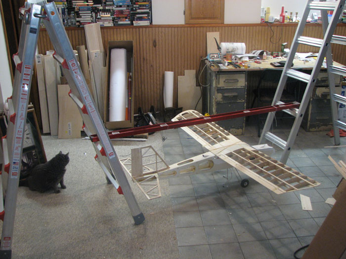

As I built my plane, I needed to balance it laterly. (Thanks to RCKen for his help/advice)
So I needed to suspend it, while I tinkered with the balance weight. I used a couple step ladders, and a long carpenters level and some string to do so. (See picture 1 below.) The contraption worked, but it took up a lot of area in a clutter workspace. I decided there had to be a better way. So I made a trip to the hardware store and bought some pvc pipe and fittings.

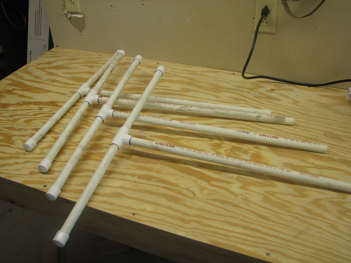

I'd need two stands. For each stand, I made two "T" shaped supports, and one cross piece.
First I cut the pvc. It took 6 pieces 2 feet long, and 4 pieces 1 foot long. I also needed 4 T-joints, 4 elbows, and 8 end-caps. (Picture 2)

1. Plane suspended by ladders 'n such. It takes up a lot of floor space.
2. pvc pieces cut. 6: 2-footers, 4: 1-footers, 4 Ts, 4 elbows, and 8 endcaps.
